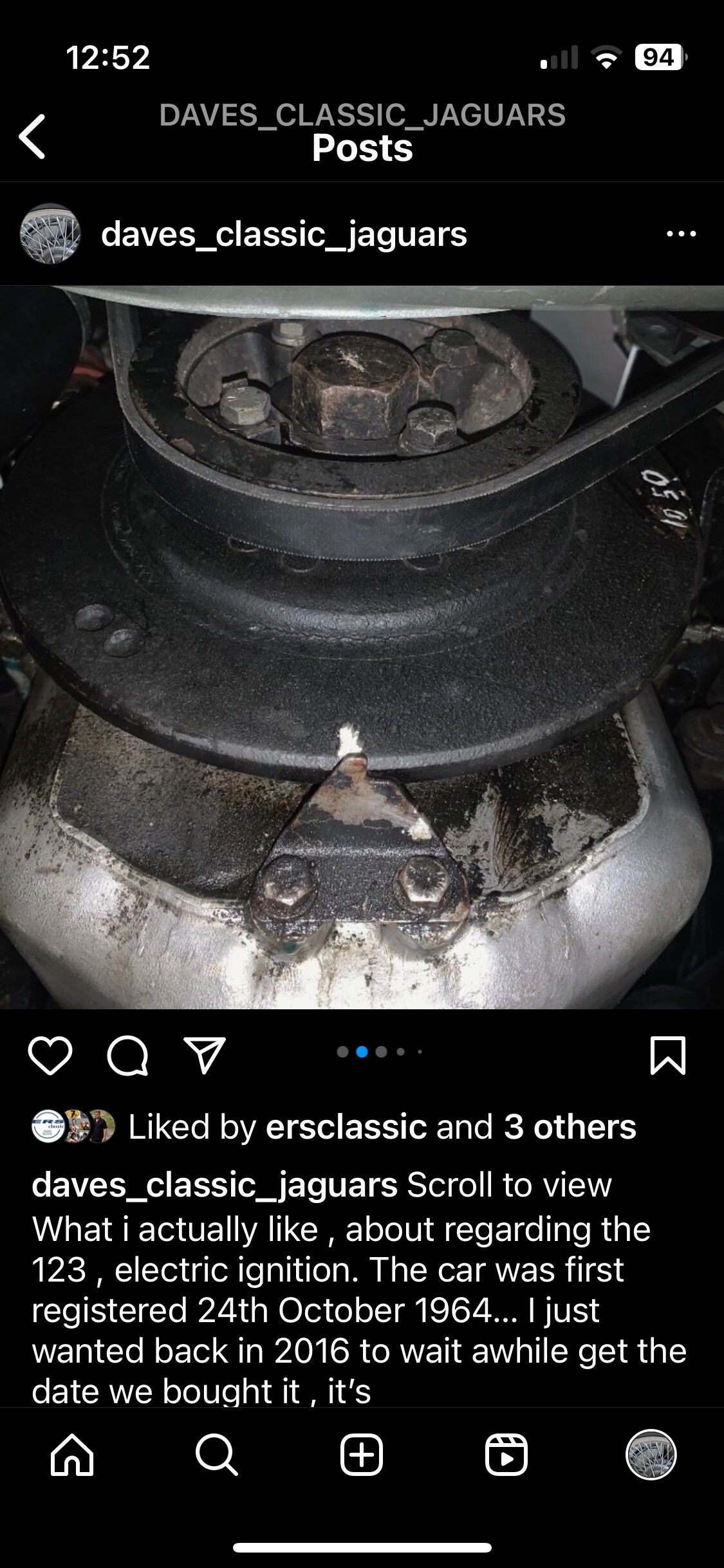

What i actually like , about regarding the 123 , electric ignition. The car was first registered 24th October 1964… I just wanted back in 2016 to wait awhile get the date we bought it , it’s
25th of the 10th October 2016… the car was first registered 24th of October 1964…. Scroll to view what we have her running with :sunglasses:…. Bring it to curve F , & out by 10 degrees you’ve a set up
… , Wosp unit ken Jenkins supplied great job … & parts also …
She’s not Bluetooth now… just a normal 16 curve …. No need for a timing light also you’ll here the smoothness of the engine like

you’d want to be years at it …. As lord to mercy my grandfather paddy o brien would say…… took me 16 hours bones of 2 days on/off …
to get this going you’ve to bring it out by 10 degrees , no question…. Your going clock wise ….

i said ok has to be curve F she took that no problem…… from what i read on the forum …. It’s in her now 7 years that marvellous ignition never any hassle
…. You might this is nuts but i actually copied from the forum another car had on his MK2 same position… I did his position with the ignition…
I said I’ll try that she worked at that , 10 degrees out clock wise
…. Years later I checked the timing she’s spot on …
