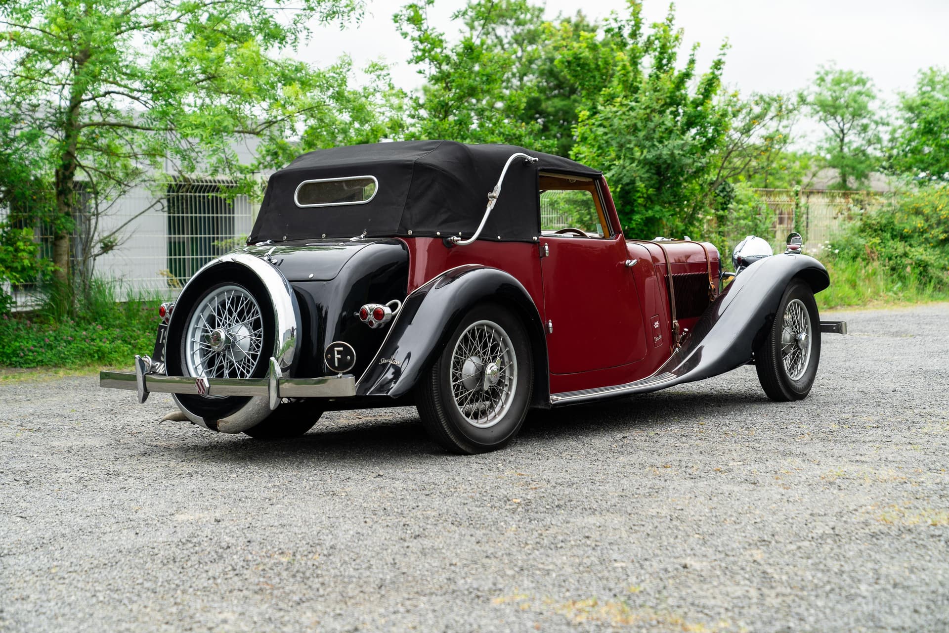

Obviously a far cry from originality, lots of wood in weird places and bling added as well as a much later (MKV?) 3 1/2 Litre OHV engine instead of the original side valve engine. Electrics and lots of other things just fabricted to the liking of the owner / restorer.

The SS Cars ID data plate says it is a 3-1/2 Litre which of course could not be true, must be a repro dating from '38 or later.
Engine probably Mark V 3-1/2L as it has the water pump extension aluminum casting only used on Mark V.
The Drop Head body was not offered on SS1 until 1935.

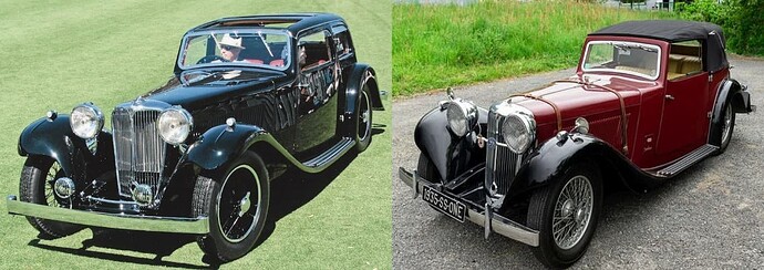

So as you say, it is likely modified from a coupe body something like this 136346.
I wonder if they widened the body? The windscreen looks too narrow but its shape is similar to an original saloon. Note also the body covers more of the rear mudguards.
Thanks for sharing the auction notice. Overall easy on the eye and may run well.
Engine appears approximately Mark V.
Water temperature gauge bulb and capillary have altered routing and location.
Thermostat housing modified for different radiator feed path, closing off front flow and bulb sites.
Carbs have what appear to me to be XK short-neck suction-chambers.
Unclear to me what fuel pump model is used.
Windshield surround is pretty substantial, encouraging a “remodel” interpretation.
The spare tire carrier sure will easily give a scrape on uneven ground.
