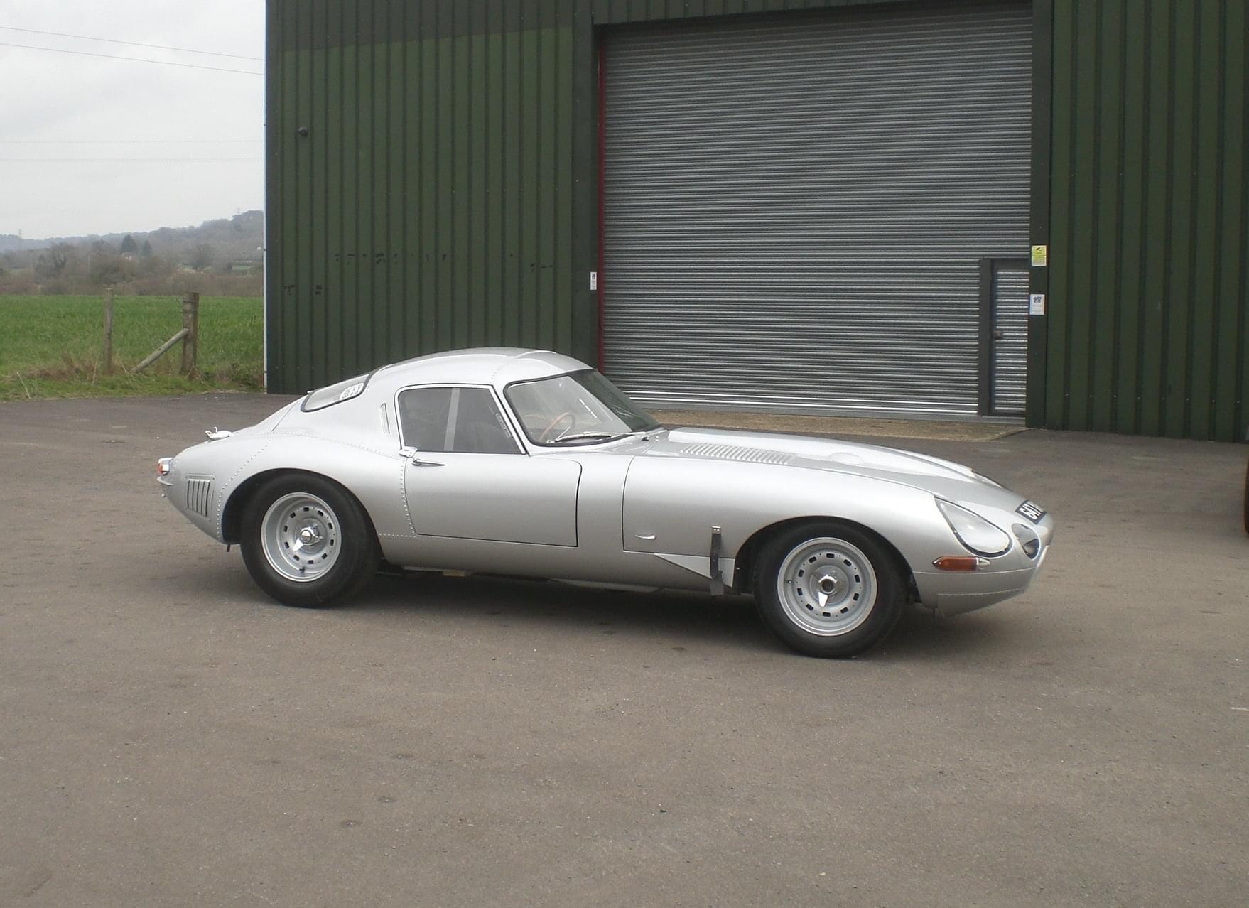

My shell was built by Racing Jaguar Panels in Bedworth U.K. the same place that builds Building the Legend Shells, also responsible for many Jaguar Heritage and period racer shells, new and or restored.
The owner explained to me that there is not one single panel from a Lindner Nocker shell that would fit a standard etype. Bonnet, doors, floor bulkheads etc.

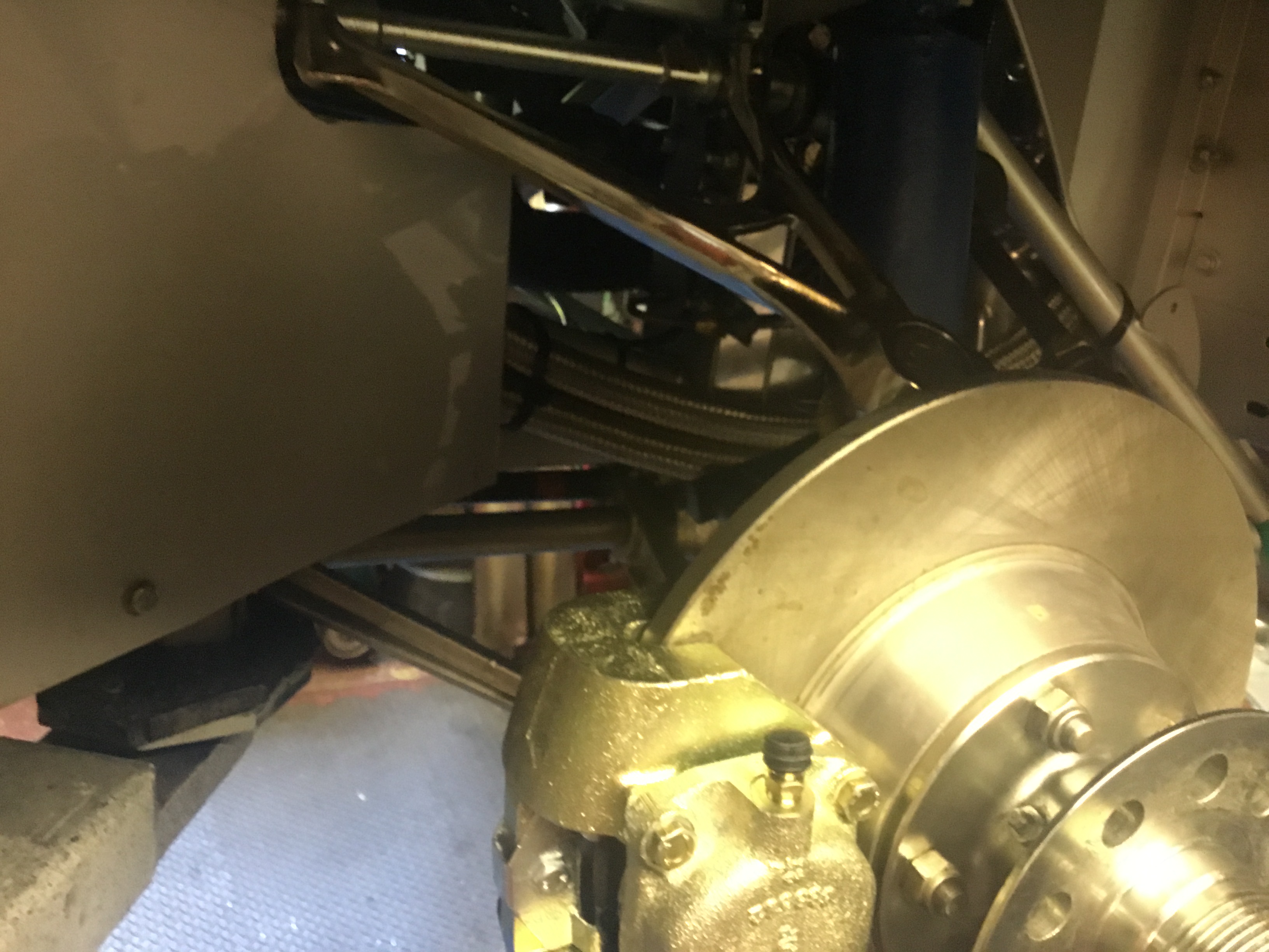

It appears the front cradle on your car is steel. I’m assuming that is how the original cars were built as well but would love to confirm.
Also I really like you suspension components. Do you mind sharing where you got them from?
Thanks
The front frames are Robey standard, the picture frame is S2. The LN had standard front frames. All front suspension is standard 3.8 S1, nickel plated. Top wishbone modified to LN spec. Front shock absorbers are Gaz with spring helpers. Not fia compliant
