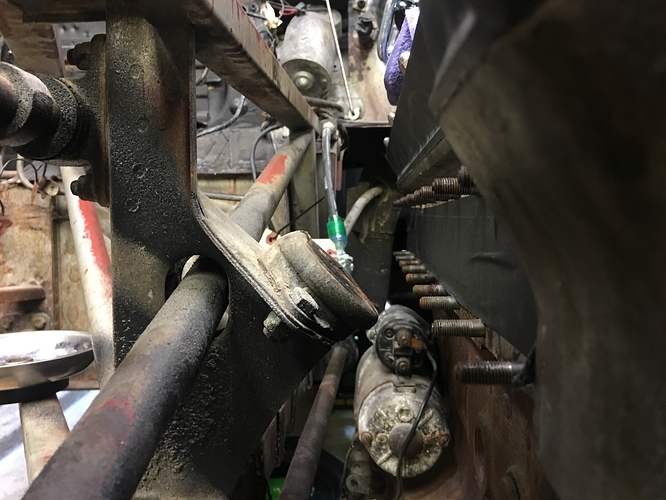

#2. Do these engine mounts look usable or should I replace them? If replace, is there a recommendation? Go to OEM or is there any advancements in material/design?

No, those mounts are junk, and Ill send you better ones, that cost FAR less than from ‘the usual suspects!”
