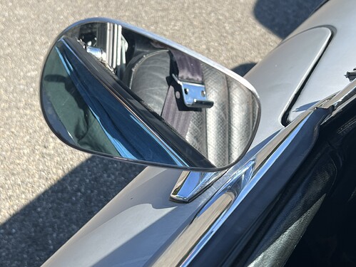

here are some pictures of my late S2 OTS US „1971“-model. There doesn‘t seem to ba a part number on it, only patent numbers. I know it doesn‘t answer your question, just showing the 1971 mirror.

Martin, thanks for the photo. My mirror is the same. The new mirror I purchased made by TEX has a shorter stem and where the mirror attaches is curved down and points more towards the door. So when you are in the car you can only see you shoulder. Is there any other manufacturer of this mirror.

Steve, my mirror is original to the car. The picture that Martin put on is exactly what my original mirror looks like. The round opening in the original mirror is parallel to the road and not bent down and pointing towards the door.
