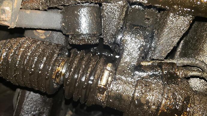

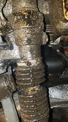

Here are pictures taken where the oil apparently originates from under the front right side of the engine compartment.
Anybody “been there, done that?”
I am hoping for an relatively easily-fixed source.
Thanks in advance!
Getting it clean might help but I would suggest that its from the steering rack possibly, some have oil in the boots, yours is obviously split and needs replacing.
Typically there are several leaks. There’s just too much oil everywhere to tell where the leaks area The area needs to be cleaned then rechecked. In any case you need to keep the oil off any rubber parts like suspension bushings and any hoses. The oil deteriorates the rubber. Looks like your steering rack bushings are shot

Thanks for the replies. Actually, I was going to rebuild the steering rack last year. But now I have more direction. The front end is up on ramps. I will clean up the oil, take a closer look, and then schedule the steering rack work.

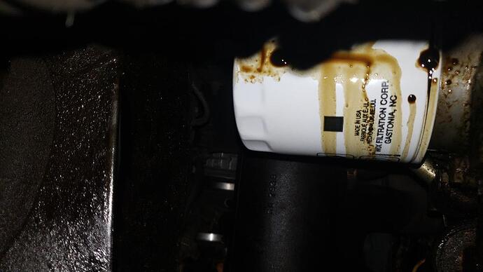

The oil filter is wet - start there. Clean everything with brake cleaner, take if for a drive, check again.
An easy start- thanks.
Oil filter could indeed be the culprit here. In the words of Nick Lowe, “take it from a fool who knows.”
Replaced the oil filter, cleaned things up a bit, then drove it for a few miles. As you can see, the oil filter seal is OK
, but oil is dripping on the top of the filter and streaking down. Oil1 is taken from below, Oil2 is from above.
Now removing the intake assembly for a better view from above.
Cam cover gasket, but that oil needs to be changed by the looks of it.
