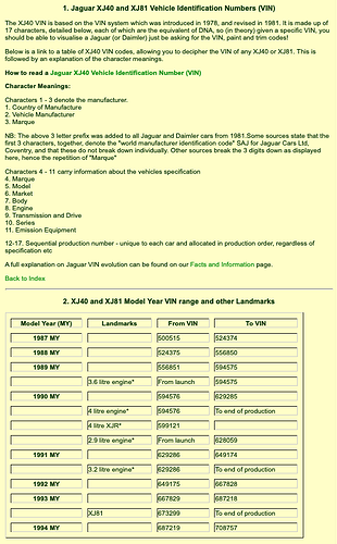

First thing find your VIN number …
You can plug in your VIN to determine which model you have and where to find all the part numbers using this website (now that you own an XJ-40 this will be your parts bible :innocent:) …
