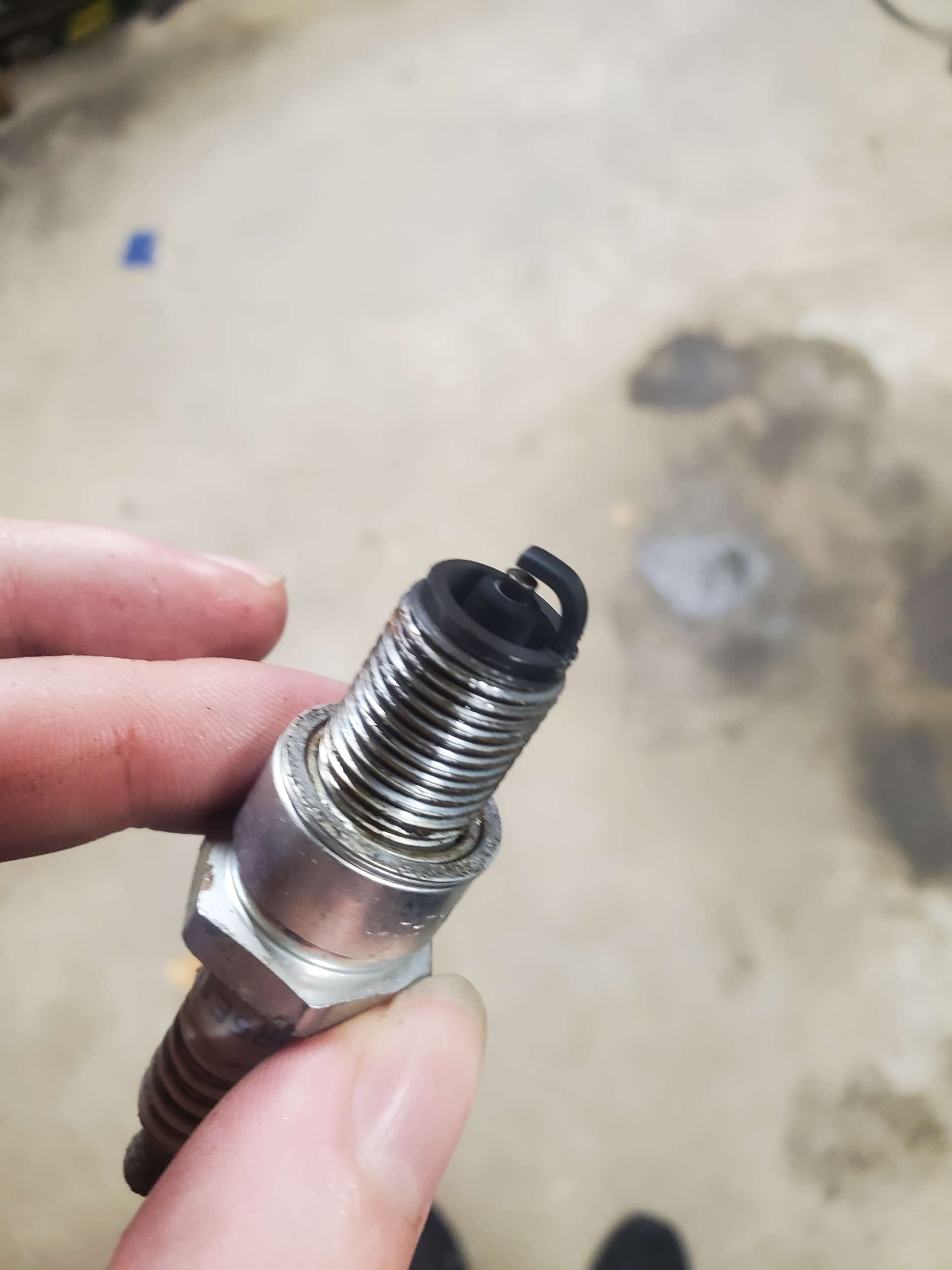

Looks normal for idle. Which one is #1? Try again just after the engine dies, maybe 1 is wet. Clean the plugs ( say 1&2) a little and see if they both got black the same.
Test shows engine itself is in good shape, Graham - no engine worries…
The first picture shows more soot than the second; which cylinder is which - and are all the other like the first or the second?
Bear in mind that the engine has not been driven ā€˜properly’, and with lots of idling I would expect the others to be more like the first picture - which is ā€˜normal’ for cold, fat running; the second picture seems too lean/clean.
However, the heading says ā€˜extremely rough running and cutting out’, as was described i your original posts - has anything changed?
Again; disconnecting one plug at a time is unreliable for detecting a failing cylinder. A crude injector test; * disconnect CSI and coil positive - and crank for some seconds*. With functioning injectors; the plugs should all be wet…
However, whether this is easier than the more precise check by removing, and testing, injectors is your choice. But referring to the above reservation; all injectors should be checked…
At this stage I would say that the first picture shows a working cylinder - the second picture shows misfiring. Either not igniting, igniting at the wrong time - or is not getting fuel…

I’ve cleaned all the plugs, I’ll see how they look after the engine runs again
Plug 1
Plug 2
Plug 3
Plug 4
Plug 5
Plug 6

Clearly plug one is the only one that isn’t shiny. Whatever you do you need to focus on this cylinder.
Put the plug onto the cylinder head and see if it sparks when you crank. I think it does, after all it is combusting. That leaves you with the injector which is probably faulty.
Also the above but I don’t think that’s the issue - doesn’t the Lambda sensor take ages to warm up? As far as too rich goes these plugs look normal.
To my eyes, the plugs are sooty. Got to remember, the plugs/engine is only being run for very short periods during Graham’s testing…as far as we know. He’s posting almost daily so can’t be running the engine for very long. SD
And…forgot to include…If the plugs are sooty, so is the O2 sensor, which, if sooted or carboned up, will also cause the ECU to richen the fuel mix. So, you get a double wammy. Hole in the exhaust header and sooty O2 sensor. SD Faircloth
Of course, but not too sooty given the circumstances! Mine always looked like that in the same situation.
My question to you is, the o2 sensor doesn’t do anything initially but the engine runs rough from the start, doesn’t that rule it out?

I’ll double check to confirm the plug itself sparks, but I agree with you on the injector at fault somehow

You’re right, the engine is being run on average 20-40 seconds throughout my testing, save for a few times a few days ago where I let it run for maybe 5-7ish minutes
I hadn’t considered that, if I have time after some more injector/plug 1 tests I’ll take a look how dirty it is
