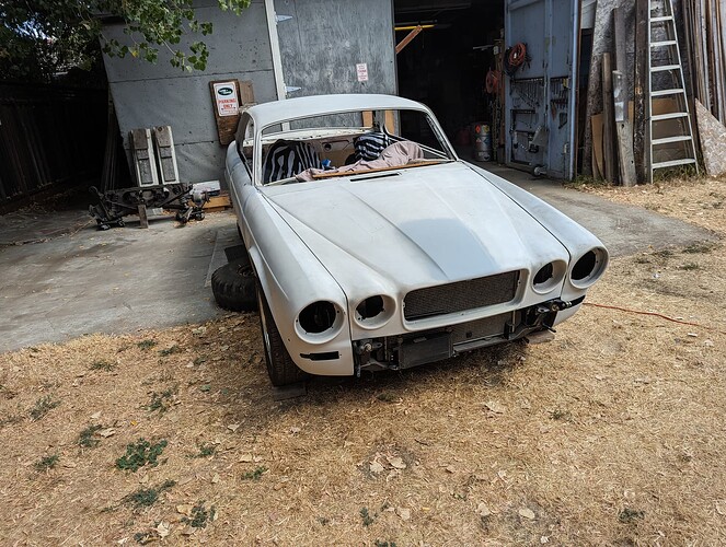

And so it begins. Restoration of 1975 XJC
Do I see a Land Rover 101 in the background - shame it is an Ambo as they are a bit ungainly. I also have a 101 GS - great vehicles.
Garry

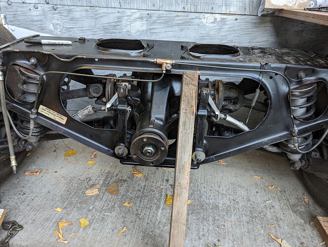

120 minutes from car on the ground to IRS out. Not bad.
But now, I need two 19"-long brake lines male/female to connect the main brake line to the outboard calipers…
Anyone has pointers to a shop that can custom make these?
Thanks.
Not mine. It needs a new home soon…
Well, after rummaging through old parts, and a trip to O’Reilly’s where I talked to a VERY knowledgeable fellow, TAHDAH!!
Used female fittings from a pair of pipes for front calipers and a pair of male fittings from the original rear calipers, + 2 20in 3/16 pipes from O’Reilly’s. Flaring tool worked perfectly.

V-mounts went in with new bolts. A moment of zen.
The 48 year old V-mount was actually still in very respectable shape…
