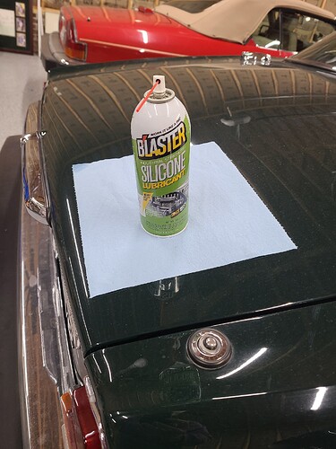

I have had excellent results keeping the electric antennas in my Jaguars working properly by using a spray silicone lubricant from time to time or whenever an antenna doesn’t appear to extend or retract properly.
I extend the antenna and wipe the mast with a handy solvent like windshield washer fluid or Simple Green and then wipe off the accumulated dirt and solvent. Then I apply the silicone lubricant to the mast and wipe down the mast. Then I retract and extend the antenna a few times applying a light coat of silicone lubricant each time. This method has worked numerous times on lazy antennas on my Jaguars over the past 22 years.
It is important not to force the antenna up or down by hand in the process. If the mast doesn’t extend and retract fully as it should, just keep cleaning and applying silicone between the extensions and retractions until it does.
Paul
That’s a great idea, Paul. I will try that next time any antennas get ‘lazy.’ Thanks
