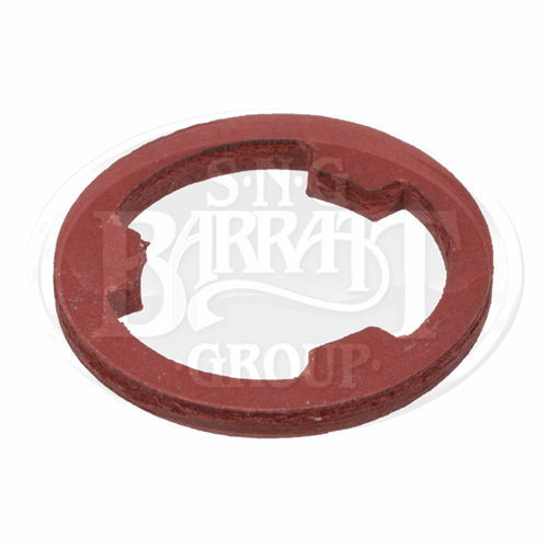

Which washers are you speaking of exactly? There are fiber washers on the fuel rail, and on the overflow tubes. IIRC though the ones on the tubes are special though. They have little interior cutouts to allow the bowls to vent. I would not substitute anything for them. I do not apply high torque to the top fuel bowl nuts. They will definitely strip, and it’s not really necessary. If you’re seeing a lot of leakage up there you have a bigger problem. It means your float valve is set wrong, or defective.

I’d add that the overflow tubes are the least likely to leak, because the fuel level should be well below the level of the overflow. Make sure you have good needle valves. Also make sure you use the oddly punched washer under the banjo.
