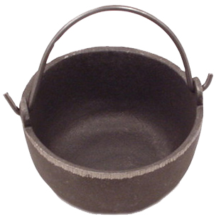

I use 20/80 because it has a wider plastic phase and it’s cheaper. I make
it by combining a 1# bar of standard 60/40 solder with 2.5# of pig lead from
a plumbing supply house. I melt it together in a cast iron lead melting pot
and pour it into a bar mold I made from a piece of stainless steel angle
stock. The melting pot is later used to make new bars from the filings I
collect. You can’t do that with plastic!
Cast Iron Lead Melting Pots
