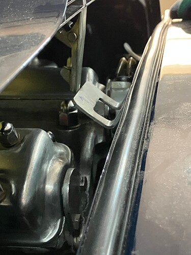

same old bonnet catch. Upon reinstall I get this:
“Missed it by thisssss much…” Tried bending the bulkhead catch but it didn’t get any better.
Any suggestions?
I got something similar on my Series 2. I added a couple of washers between the forward edge of the catch on the bonnet and the bonnet panel which tilted the catch enough to engage as the bonnet was closed. Not exactly factory, but functional…
Bend it so that the portion the red arrow is pointing too is more horizontal which will extend the piece contacting the latch toward the front of the car. To get the bonnet to close more smoothly you may also have the alter the angle of the bend at the yellow arrow. I had to do that to mine after I had the cr painted and was realigning everything and it doesn’t take much.

Any way I tried the shims…not enough. So I bent the bulkhead catch…this time more successfully. Seems to be working however…I will check again tomorrow to make sure the car hasn’t changed her mind and decided not to work again…which has been known to happen.

I’d use washers instead of bending the hook. You can either shim the two leading bolts for the hook, or you could shim the whole latch forward or some combination of the two things.

And she seems to be accepting the modification. I think I a m good. Anyone see anything wrong with this alignment? thanks.

In this orientation can the hook fold back far enough to slip into the catch, and can you comfortably release it again? When it’s 160 degrees inside there, and you need to open the bonnet, you don’t want to be trying to force the hook to release.
seems to slip in with a satisfying click and I am able to reach in with my fingers and release it. It’s not easy to lift the hood without the counter balance springs but the catch does not seem to be a problem. Unless she changes her mind and decides to be difficult in the future
