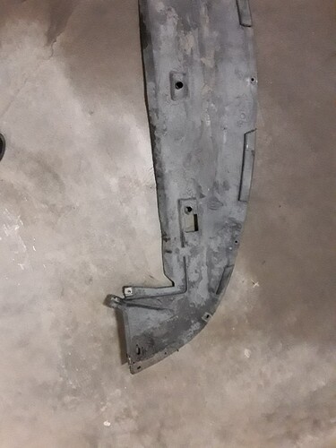

How important is this cover , out of fiber, attached at bottom front with 12 screws ? It takes about an hour to remove 12 screws to hold it up.
Does it have any value to have it attached on the bottom front.
Thanks for any reply
Walter
stone guard - protecting hosing ect,…assuming that you are talking about the same thing

can you post a picture of what you are referring to, manufacturers design items for cars for a reason
Tom!
Will take a picture.
Its 18 inches by 5 feet long.
Its held in with 12 screws.
I just see no reason for that cover on the front bottom.
Walter
tom !
Sending you some pictures of what the bottom front
looks like with the cover off.
                                                   Walter
Walter, on the X type 2002 Jaguar Front panel???
walter,
you can choose to have on or off it’s your car, however the cover is designed to deflect any road rubbish potentially been thrown up off the road from other vehicles, it’s also a warning that you my be too close to something as you’ll hear a nasty scraping sound.
