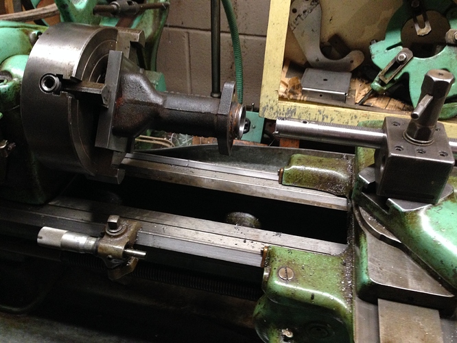

As I suspected… I must be delusional because I still like to fix everything myself. Here’s a photo of me about to machine my master cylinder for a ss sleeve.
Whilst I like the idea of doing it myself and have the equipment ….nah get the pros to do it …it’s braking system ….I want to make sure I have the very best chance of not killing myself
Bill, if I had my own lathe, I could most certainly do that for my own cylinders: would I ever do that for a customers?
NFW.
