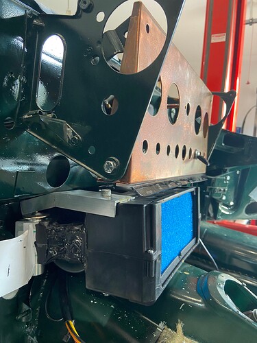

Those of you following the progress on the 2+2 know about the mechanical alterations I’ve made to accomodate air con in this car
So I have found the evaporator that Clayton’s use and am building my version …. So here is the start of the install
Today I measured and made the brackets twice !
Undid 3 painted in screws ….and sheared the 4th ……drilled out the stub
Tapped the threads …broke the tap in situ …. After failing to remove it … drilled new hole for bolt and nut ….otherwise went well!

Assuming the blue is a filter, should it not be placed near the inlet instead of the outlet? Just asking, I don’t know anything about AC except I wish I had it.

Yep that’s what I thought too …… but that’s how it comes Tom …… I haven’t addressed how I will attempt to filter the recirculating air yet …… I don’t want to pull it all apart each time!...original ac’s in jaguars had no filters at all and it is internal air only …. So maybe I don’t need it …… the only issue as I see it will be fluff of the new carpet ……. The sides will have “speaker” grills in them to aid flow and there will be a gasket around the front between the face and the metal front plate .
The blue foam on the evaporator outlet is not a filter. It’s supposed to prevent water from spiting out of the evaporator unit. DO NOT REMOVE the blue foam!
