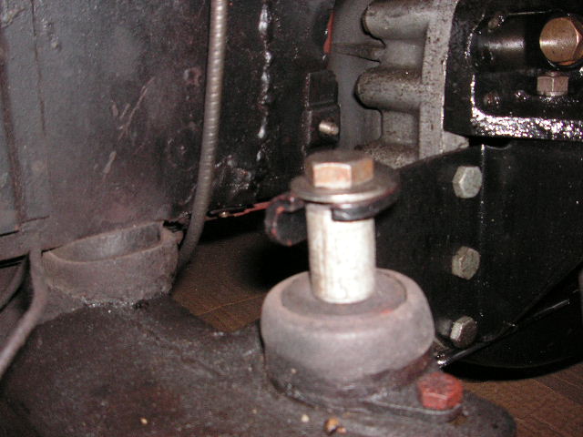

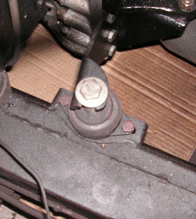

There should also be 90 degree angle brackets on both sides, the non-steering side being also a stabilizer.
XK120%20engine%20mounts%20015
XK120%20engine%20mounts%20014
Rob, thank you again for helping me, I found the brackets and will be installing them! I feel you will be helping me so much you should be the first to drive it when it’s finished!
