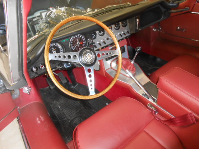

I bought one from the usuals too, it looks just like an original one to me once it is installed properly.
DSCN2804
Was it a DIY install for you? It looks good from my perch.
Mine has the rod depression but I don’t need it. In looking at it, I think it will be cut out during the trimming process.
Yes I installed it myself using heat and high temp glues. Lots of clamps and clips too. :slight_smile:
