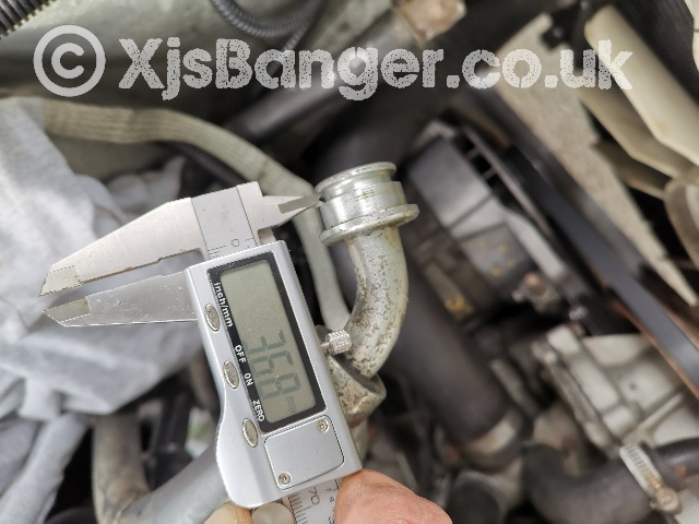

There are two o-rings there. The orings are no longer o-rings, hence your leak. There is one single bolt that holds the brwcket which holds the both oil hoses in the housing, it’s a press fit. Just get the o-rings, press in and your’re done.

I posted the size of the o-rings needed. I used viton orings from McMaster Carr.
