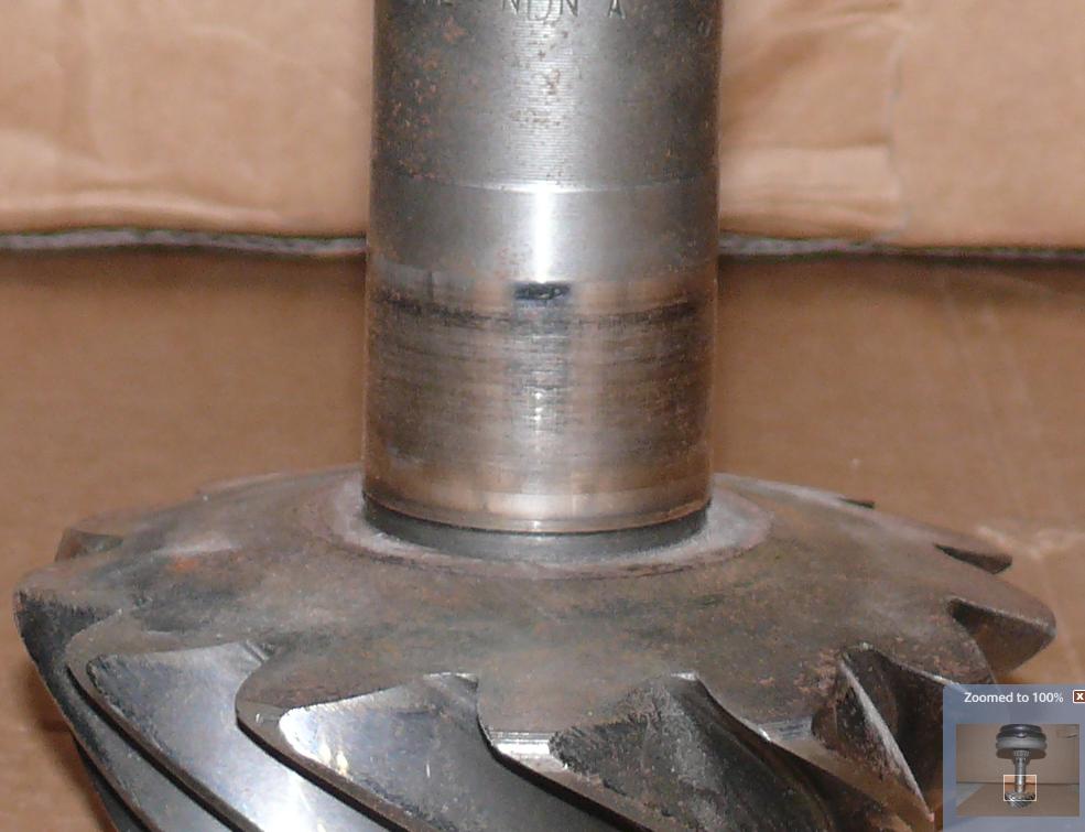

The following picture is of a Pinion Shaft from a 3.31:1 Gear set removed from an S3 E Type Differential to be replaced with a 2.88:1 Ration. The bore of the bearing (a brand new bearing - never having been pressed onto a shaft) measures 30.162mm. The diameter of the journal where the bearing is to be located measures 30.17. For a journal of that diameter and hardness, its reasonable interference. You will note that the allowance for fit of the bearing and shaft is able to support the weights, in the sum of 6.5kg (and could support a whole lot more); far more force than the effort shown in the video and shows that it is not a running fit.
The video showed that the fit of the inner bearing was interference with the shaft and despite this class of fit, the following picture, a closer view of the journal for the Inner Bearing, shows clear indications of the bearing having spun on the shaft.
Under normal circumstances, the outer bearing is less likely to spin on the shaft, for even in the absence of any interference fit with the shaft, the inner race of the Outer Bearing is clamped between the end face of the Companion Flange and the Collapsible Spacer (Solid Spacer and Shims if used). However, if there is any diminishing of resistance by the Collapsible Spacer, for whatever reason, the actual clamping force on the Inner Race will decrease, but the pre-load on the bearings will increase. This is the perfect condition to promote spinning of the bearing on the shaft. Accordingly, I would prefer a combination of slight interference fit of the bearing and good clamping force being applied to the bearingās inner race.
