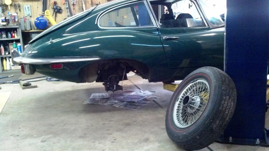

Even 185/80x15 are tight to the bump stops!
Maybe too much neg camber but going to cut the bracket back anyway.

Yes, certainly too much negative camber.
Unless damaged suspensions, even 205/70 R15 fit, although not all tyre brands and depending on cars.
But I’ve never heard of 185 too tight.
What wheels…size/ inset/offset?
Stock 5” curly wire wheels. Michelin redline circa 1977. No suspension damage or modifications but the trailing arms were not installed maybe allowing a little more than full extension.
Trailing arms installed now. It’s amazing how much they twist with the arc of the lower wishbone. All buttoned up now and they bottom out a little higher. Planning on using 205/70-15 when done.

Is that picture taken with the weight of the car on the tires or with the rear end jacked up and the suspension in full extended downward travel?
IIRC, it makes a difference as to the amount of clearance between the bump stop and the tire sidewall. It’s much reduced with the suspension fully extended, which it almost never is in actual driving.
Rear end was jacked up with shocks attached and full suspension droop. I cut back the bump stops but not enough to prevent installing the rubber donuts in reversed position.

I have 195 /75 and at full droop they touch the top of the rubber bump stops and almost touch the metal bump stop bracket. At ride height the tire will move up into the wheel well and away from the bump stops…I think.
With my car on the stands and wheels at droop, I can turn the wheel and hear the rubber squeek as it drags on the tire.
