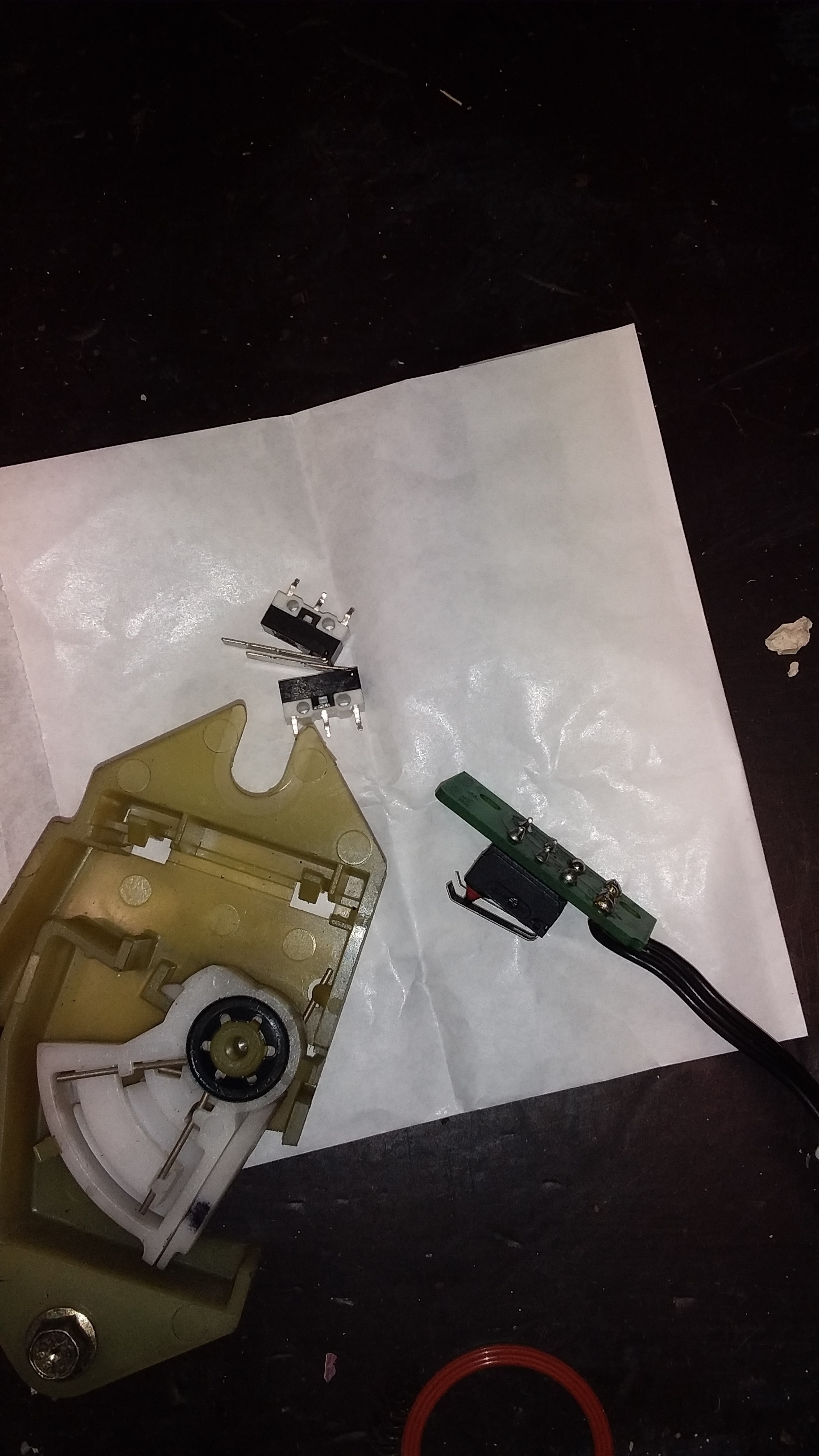

Normally I would say brake light switch on the pedal but I have just replace the micro switches with new items and confirm when I depress the pedal I get the two distinct clicks as they operate.
Now the interesting point is that only the main brake lights illuminate, NOT the high stop, I can confirm the HS comes on with the brake pedal, and I notice there is a very short period where the main brake lights flick off and then back on with the HS. Is there a module I need to be looking at?
UPDATE, turns out it isn’t the brake switch as after a drive where the fault showed up I left the engine running and disconnected the plug to the switch and the main brake lights are still glowing bright on the upside the micro switches work
