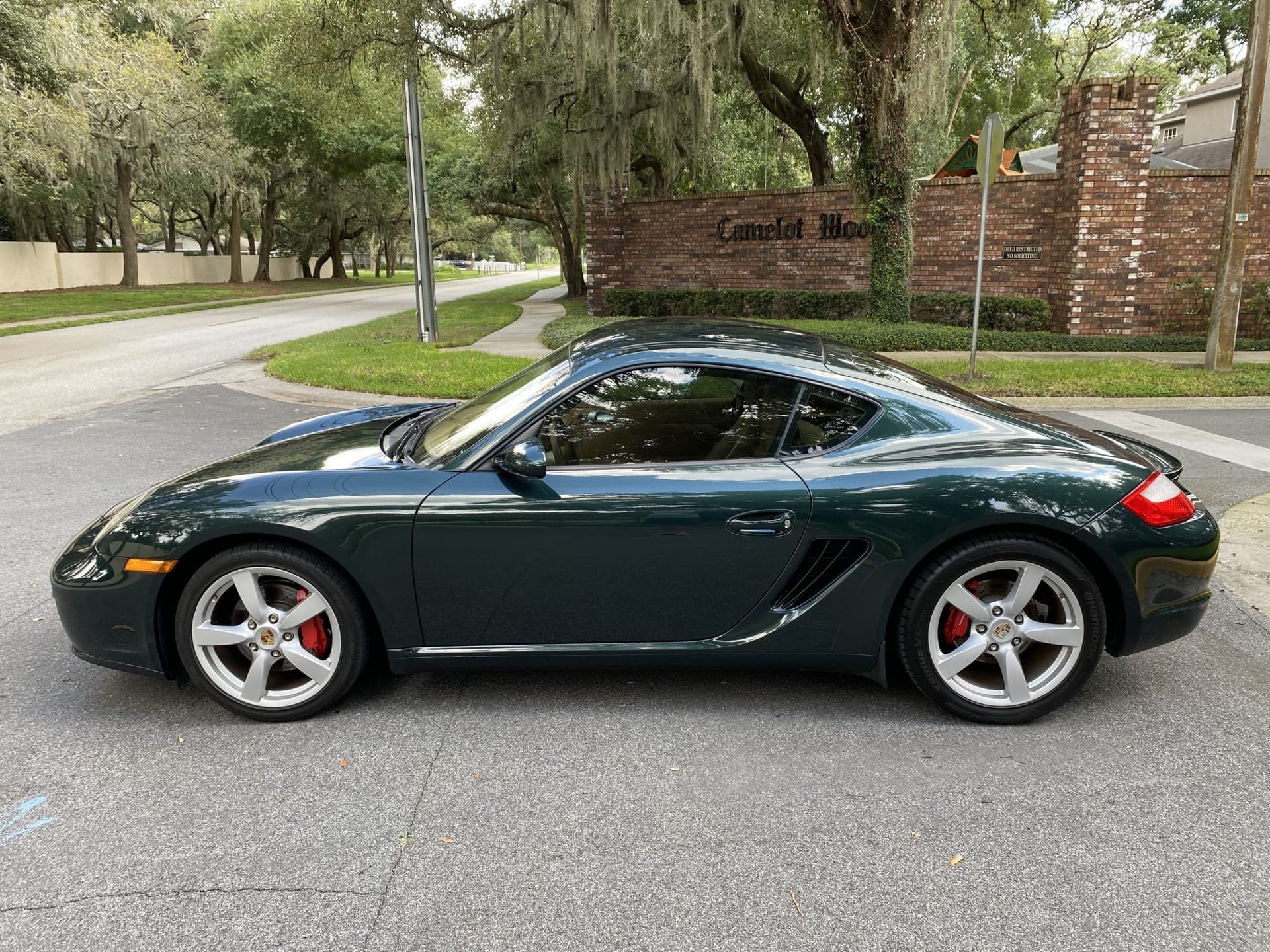

OK, that is a Click Bait title. Yes, I am embarking this week on a new journey for me, a complete rebuild of the flat 6 engine on my 07 Porsche Cayman S. I am 2 1/2 years into the restoration of my 63 FHC and, as has happened before, there are circumstances where I just need to jump out of that project for a while. This is one of them. I’ll still maintain movement there, just not my full time attention.
This is the same Cayman featured in my Road Trip articles last summer. I bought the car almost 2 years ago with almost 100K miles and my being the 5th owner. These cars can be very reliable. But there is enough anecdotal evidence of problems showing up with older cars being introduced to track duty (my intention) that I will just sleep better with a engine refresh completed. Replacement engines are getting hard to find. As I say on the Porsche forum, we seem to be blowing them up faster than we are wrecking them. A rebuild will not be cheap but once you gernade the engine, things get really expensive.
Just to state the obvious but modern cars have all been pushed closer to their limits in the quest for fuel mileage, performance, air quality, and cost. And yet we never think “Oh, it’s time to rebuild my engine” on our modern cars, as the engines tend to outlast other things to the point that we sell the cars and move on. So maybe I am being overly cautious but I guess that is the way I am wired. Anyway, I’ll be posting a series of articles to my website as I go along. If you are interested follow along. I do plan to do most of the work myself.
