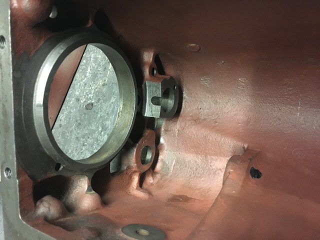

FWIW I painted my XJ6C gearbox when I rebuilt it as well as the engine block and the MKIV engine block I rebuilt last year. The Jaguar MKV Service manual suggests to do it also for the cast iron cylinder head and IIRC they say it promotes oil flow. I don’t see any harm it could do as long as you don’t apply paint on machined surfaces or any holes etc.

I don’t think there is any great fears with a gearbox.
Nope! Built-in paint grinder!
