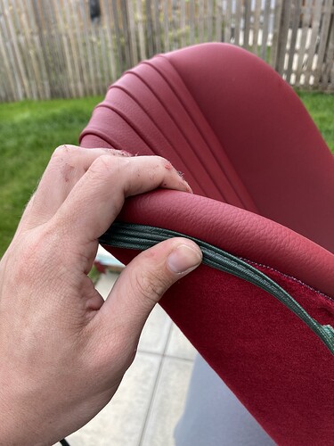

Evening guys, I am redoing a semi lightweight e type and the aluminium seats have a complete piping edge which consists of double piping with the seam line on the outside with a clean edge and the piping is made as such that it creates a channel to staple through and the pipe hides the staples. Question is, does anybody have the attachment for a sewing machine for this. MASSIVE ASK I KNOW… Iv tried always to do it manually and it’s just not right.
Most upholstery places have that. It’s called Hidem welt.

This is used on Chris Craft Boat upholstery. yes, Hidem welt. If you want to sew it, check fabric/sewing stores for a sewing machine presser foot that adjusts so that you can sew on either side of the foot. though on the boat it was stapled in.

The supplier I use actually stocks it so I ordered from them I just figured it was a dated technique. We live and learn. But I ordered for a Saturday delivery as the interior trim is going on Tuesday and they’ve failed to show Squeeky bum time
It was the piped version I needed also
