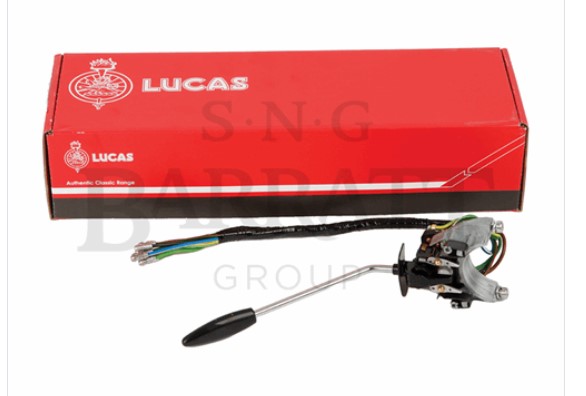

Can I suggest that you stop guessing and, as a result, have lots of forum folks spending their time offering you advice that will not help you and wastes their time. It is really easy to determine what horn switch you have. Just look at the turn signal switch that you have on your car and compare it with the illustrations on a vendor web site such as SNG Barratt. Here they are - I’ve done it for you:
Horn operated by pushing the end of the stalk of S1.5, S2 (and apparently all 2+2 cars - even S1s according to SNGB):
Horn switch not in stalk of S1 cars - note the skinny stalk:
If you car has the skinny stalk, then the horn switch may be under the push in the center of the wheel (or maybe your car has been modified, and now has no horn switch at all). Removing the center horn push is as indicated in an earlier post by @DrewScherz
If you then find there is nothing behind the wheel center horn push, then you have a problem. Good luck, and please report back on what you find and how you solve the problem. This could help someone else in future.
