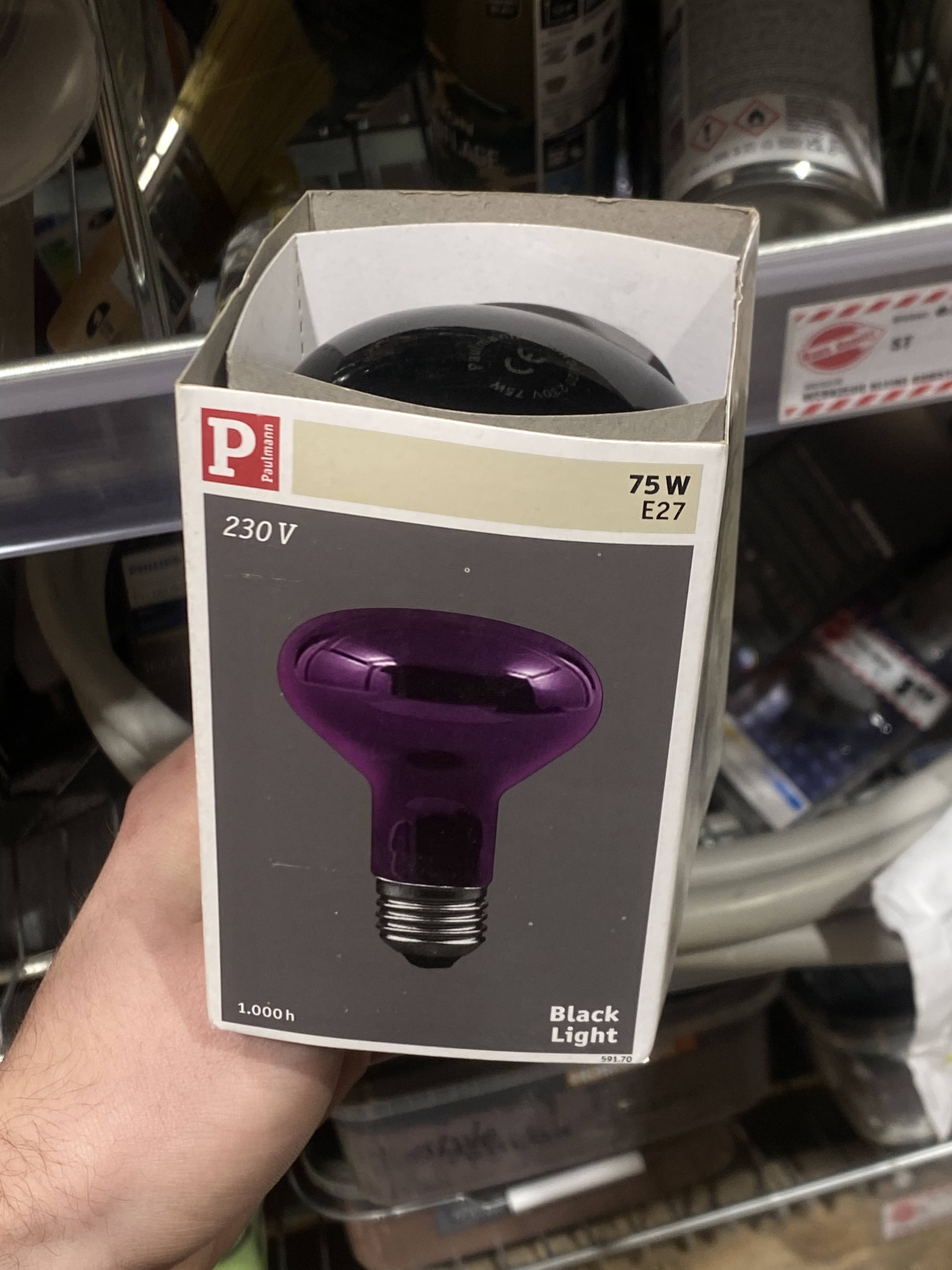

Bit late but today at the hardware store I found the last of its kind, a rare dinosaur, on the clearance rack…
When lit it looks exactly like the Jag instrument lights. To find this just days after thinking about it.
Black lights… good for huntin’ scorpions!
