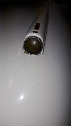

Side lights , one’s on the car are 1968 , so lasted well , but the plastic lens are very yellow , I managed to get some original Jaguar one’s , have put LED bulbs in them , brighter , less heat so may help to stop the lens discolouring !
