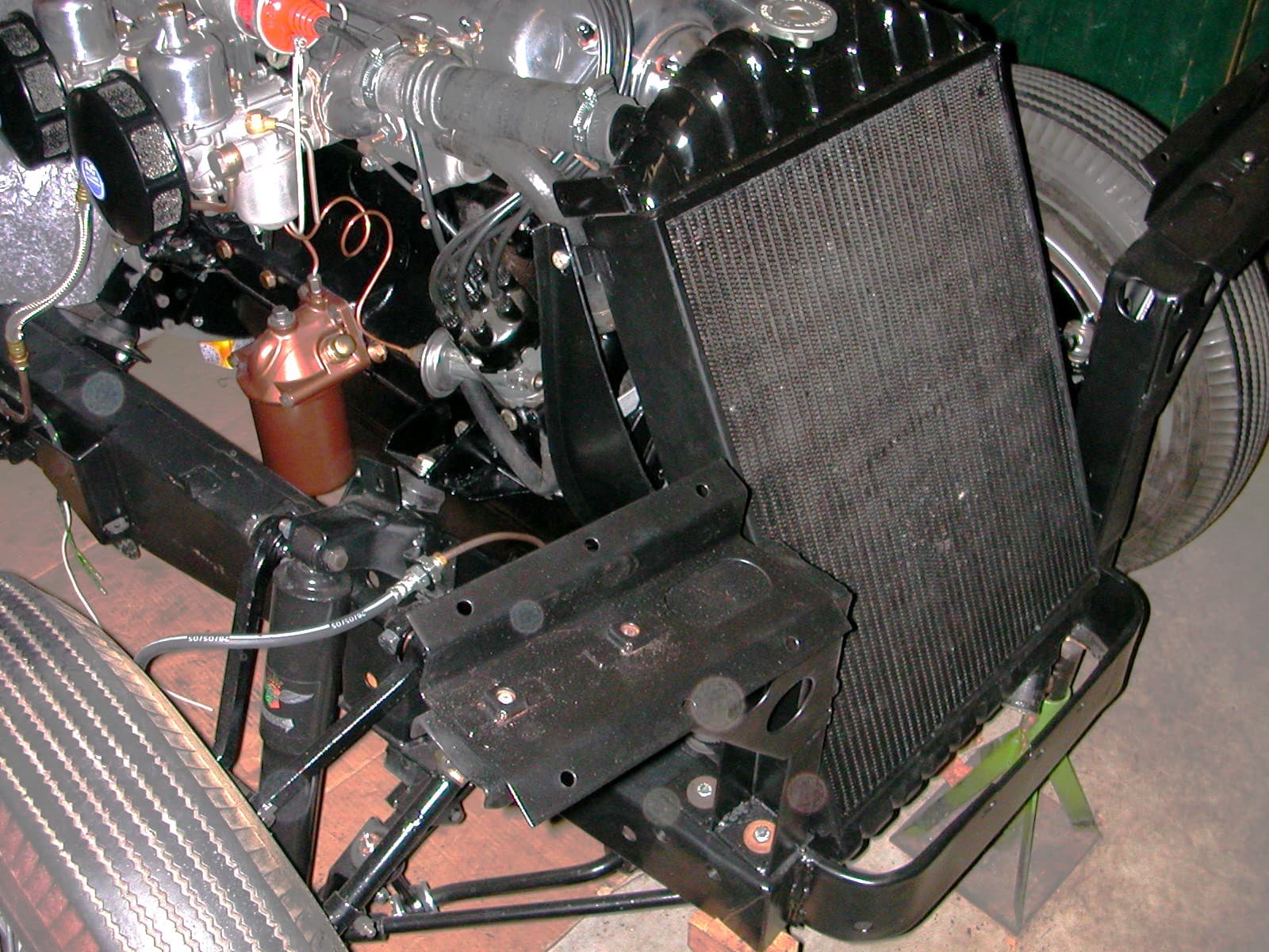

This the tag on my radiator, clearly the P102 15A. Any suggestions on where to get an original P102, since that is the later version? Seems that NAR is the best bet for a reproduction.

Craig,
Although the serial number is somewhat difficult to read (I guess 1110) it was probably fitted to an early 1955 XK 140. These numbers would run up to around 2500. before the radiator was modified.
The later radiator version is totally different and I’ve added some pics of my August 1955 XK 140 radiator, just for comparison.
Bob K.
Maybe Marston stopped putting their tags on the later XK radiators simply because there was no room with those ribs on the top tank.

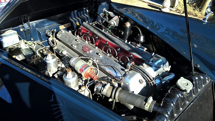

Your photo also reminded me that I need to paint my oil filter housing that brown. Did you do that? Do you happen to have a color number? Thanks
I found Plastikote FM8112 for 1980s Ford Truck “Desert Tan Metallic” is about as close a match as anyone could ask for.
oil filter 007
Original 120 and repainted 140 heads.

Here are some photos of the oil filter from my November 1956 built XK 140 MC OTS. I elected not to repaint the cannister as I wanted to preserve the color and the lettering. I don’t believe there was any sign of old paint on the top so I just cleaned it up a bit.
Good decision Bob, these later FA.2708 Oil Cleaners with bottom-up main bolt, have the painted on label which would not be easy to accurately replicate, although clear stickers with white printed on lettering are available. These FA.2708 Oil Cleaners were used on XK140s from Engine No. G6233 to the last, and as you show have the same opalescent brown/bronze cannister, but the Head was not painted, remaining bare aluminium as you have done… See attached pic of another exceptional well preserved original paint/label FA.2708…
The earlier Oil Cleaner FA.2690/101 as per all three of the previous photos were fitted to XK140s Engine Nos G.1908 to G.6232 and as shown, had both the Cannister and Head painted the same Tecalemit Bronze, or as I describe an opalescent brown/bronze
