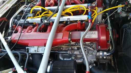

if only i was younger and still had my shop, few pix, of my build!
. . . .ron
pix of my 1975 XJ12C , 4 speed manual (sold), big mistake, prices have skyrocketed, whooda thought! . . .
ron
