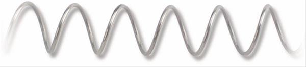

Where do you buy an internal spring for the single radiator hose?
Here’s one source.
and another
No dimensions listed but they could probably tell you if you called them.
OK, I found he correct lower one piece radiator hose for my 70 S2 on Amazon. For future reference it is a Gates number 22082 and it came with a spring already inside.
