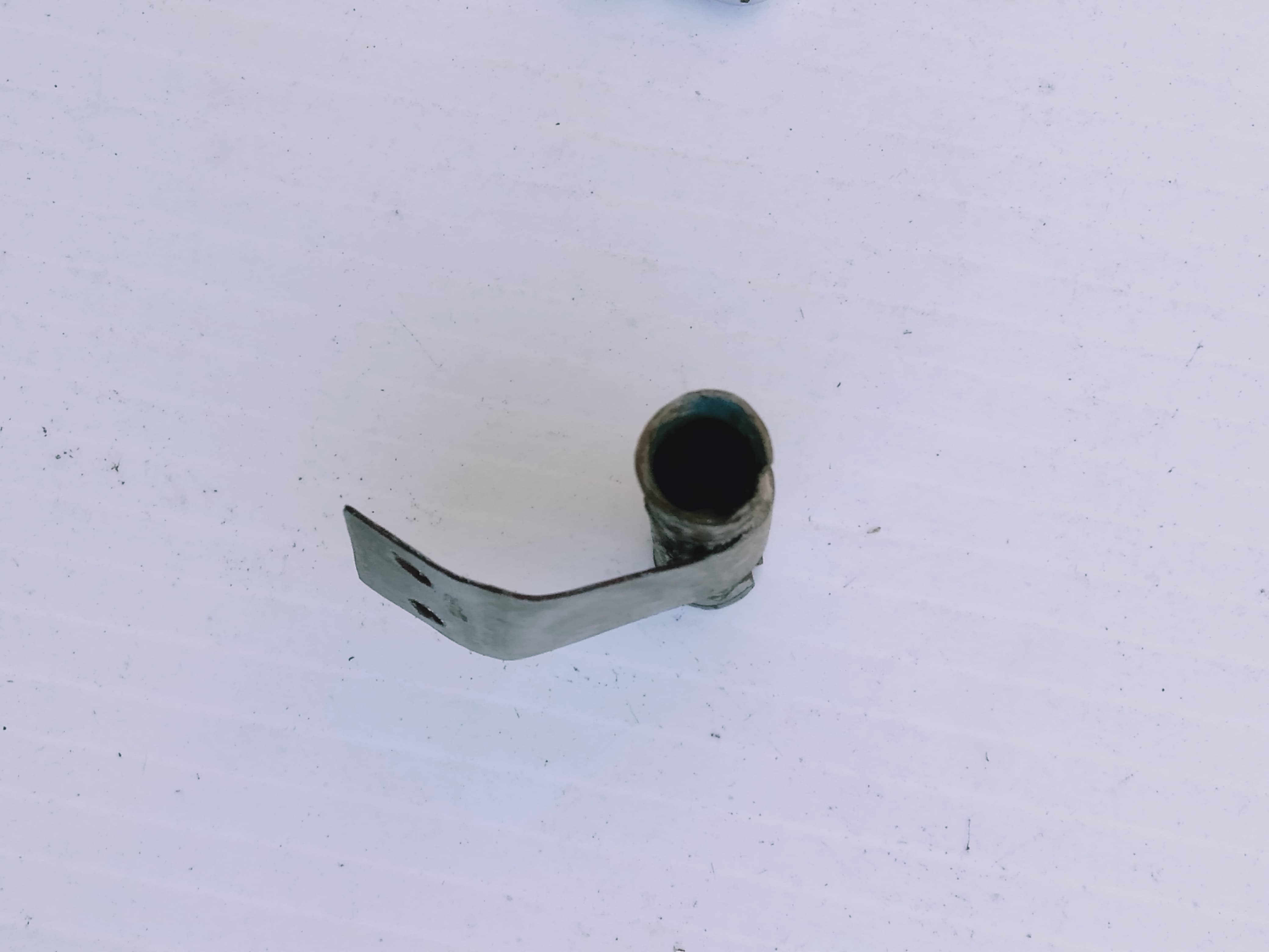

Hullo Dennis,
For the rear blind, the route of the cord is simple and I can send some pictures. The hardware for it, starting from the front is:
  • Anchor knob, which is a nice ivory coloured plastic;
  • Guide bracket behind the headlining above the driver’s head.

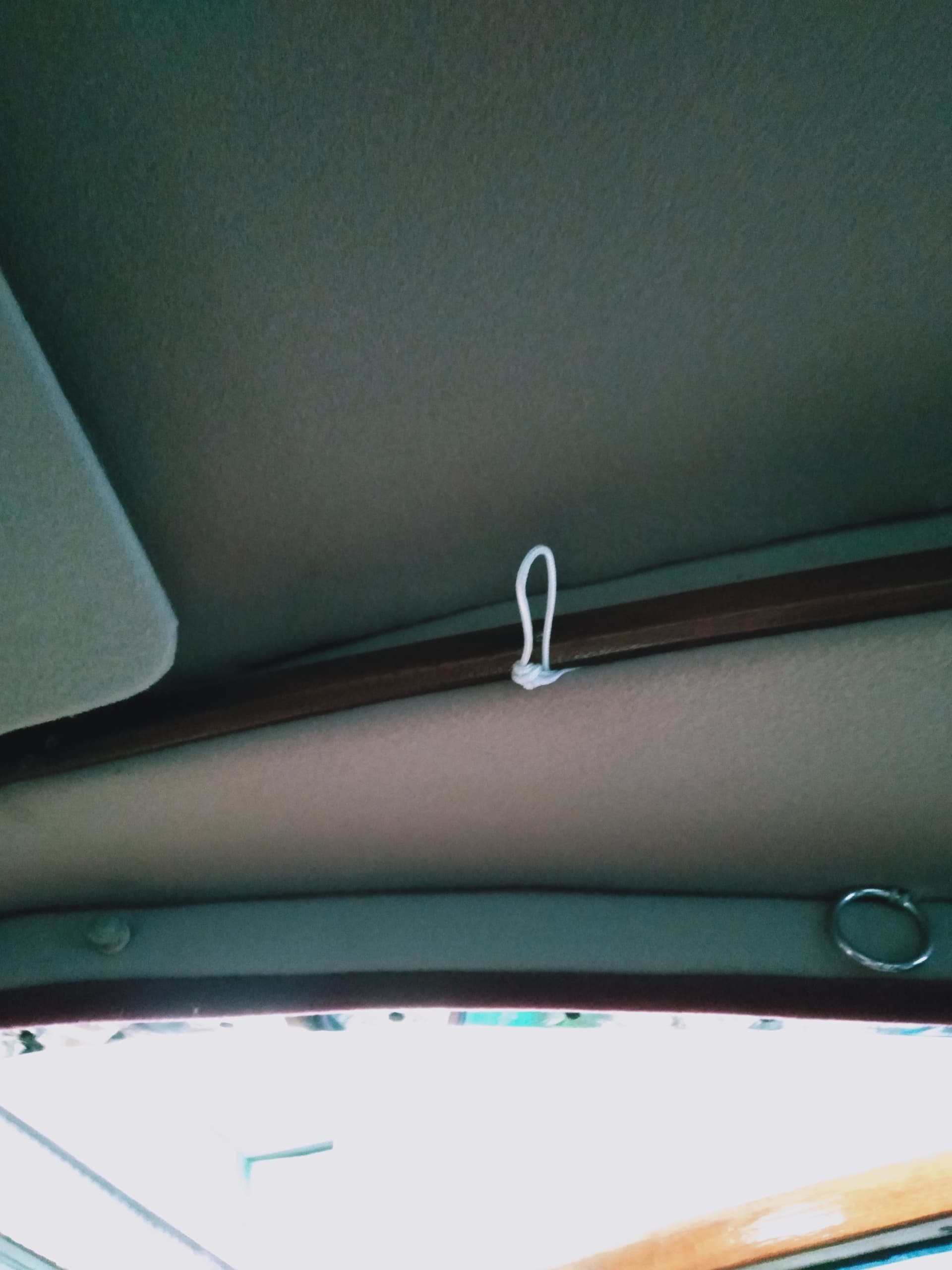

    For the rear you need five chromed eyelets, four in the rear bow and one in the forward bow. The bows are made with tapped holes for this.
    The cord runs freely from the front bracket behind the fabric, through the cavity under the sunroof recess and through a hole in the wooden bow at the end of the sunroof recess. From there it is ‘overland’ through the eyelets. A few pics will fill in details.

A few notes about my photos.
  • ignore the cord loop hanging down, it’s for tying off ribbons when I did a wedding.
  • I had to remake all the interior plywood pieces due to age-related delamination.
    The cant rail continuous strip is secret-fixed to the ply backing strip and I replicated the original tacks system, but some use hook and loop. The anchor knob must screw through into the backing ply, and I suggest not installing it until you’ve run the blind up and down to determine the upper holding position.
  • the exit hole for the cord is there and you should find it easily if you poke around with a clean prod.
  • if the eyelets don’t screw in easily, tap the holes through as it is easy to shear them off.
  • it can take a bit of patience to probe the headlining to locate the holes in the two bows. If the bows have not been installed in the right places, the headlining needs opening up to rethread them. I have seen some set up with the fourth eyelet on the rear bow eliminated but it looks terrible.
