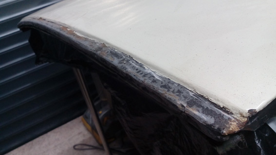

Hi all.
I’m looking for a photo showing the front of a Mark IV sunroof.
It appears there is a rubber seal?
Cheers, Graham.

It should have a thin rubber seal on the front edge. I could not find a supplier of these seals. My old one was rotted and easily peeled away from the sun roof. Once I had cleaned up the sun roof edge I used a very thin black rubber flat strip (about 1.5 inch wide) to form the weather seals, and glued it in place and used clips to hold the shape. Once the glue had dried I trimmed it off to shape. Here are a few pictures if it helps:
Ed’s pictures from the pdf file.
