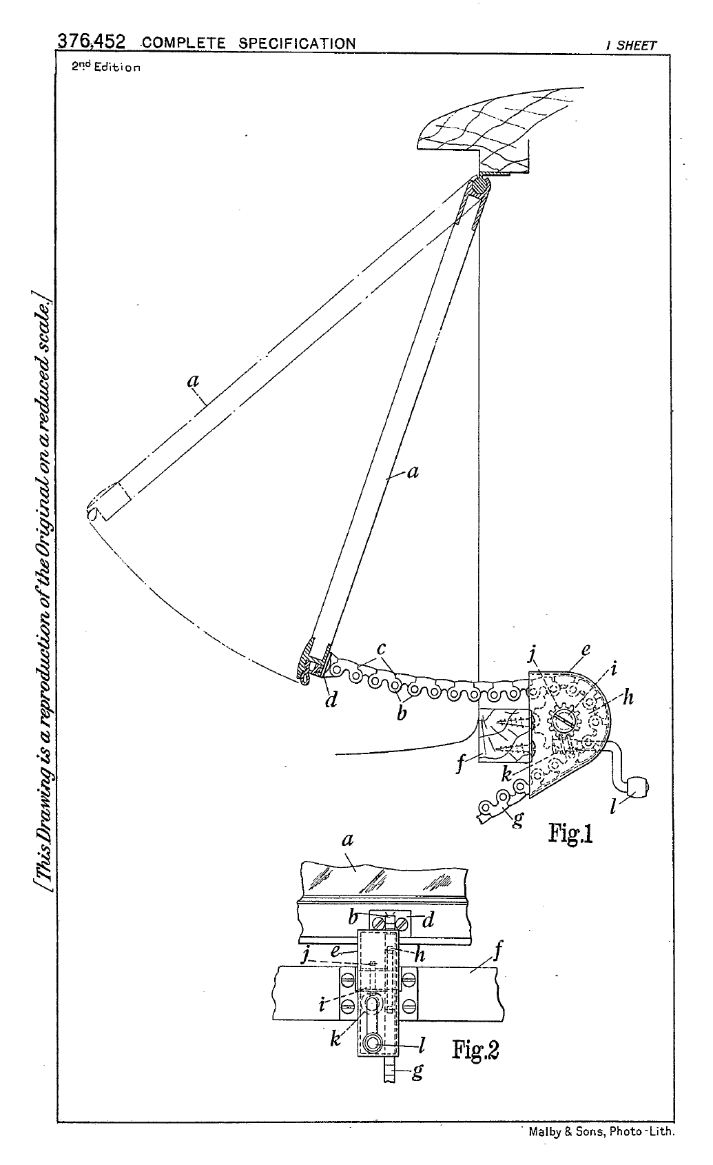

I got curious to know if there was a manufacturer’s mark on it, so I removed mine, but there was no mark on the chrome handle. The plastic knob is marked Cox & Co. Pat. No. 376452. The handle fits a shaft of 3/8" dia with 20 splines. The screw is a 2BA x 1/2" chromed round head. The shoulder screw for the knob is also 2BA.
The inventor of the crank opening windscreen was Rowland Wilton Cox of Putney, who filed his patent in 1931.
