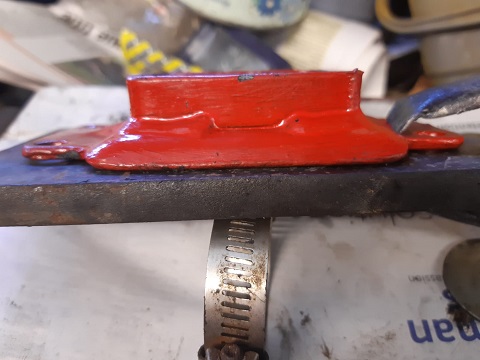

Another modification I have done is , replace the Rear Spring Clamping Plates, with uprated one’s
As you can see the old one’s are well bent !
