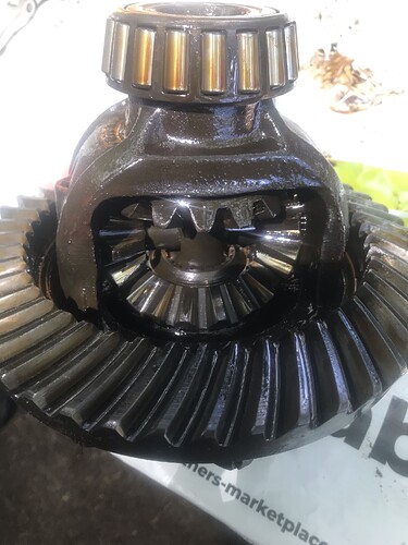

My brother and I broke down a spare MK 7 rear end this week and the differential is much better than my original and I will be using it in my rebuild.
New bearings and seals all around and a restoration of the backing plates and wheel cylinders are in order. Amazingly the shock links were intact, pretty rare for a Jag of this age. I have seen 7’s with them entirely missing.

I hope you’re not putting a 4.27: to 1 back in there. I put a 3.54 assembly in mine. (not R & P) but whole cluster together. That had to be one of the best changes I did for an everyday driver.
Was yours a manual or auto?
Mine was manual w/o OD.

I am staying with the 4.27 ratio. My 1953 built MK 7 has the original model of the Borg Warner automatic transmission that starts off in intermediate gear when Drive is selected. Low gear can be manually selected and manually shifted to Drive to attain second and third. It takes off adequately from a standing start and I am happy with its overall performance.

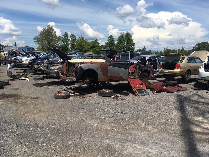

Sadly, this once-magnificent 1961 Mk9 ended up in the junkyard.
