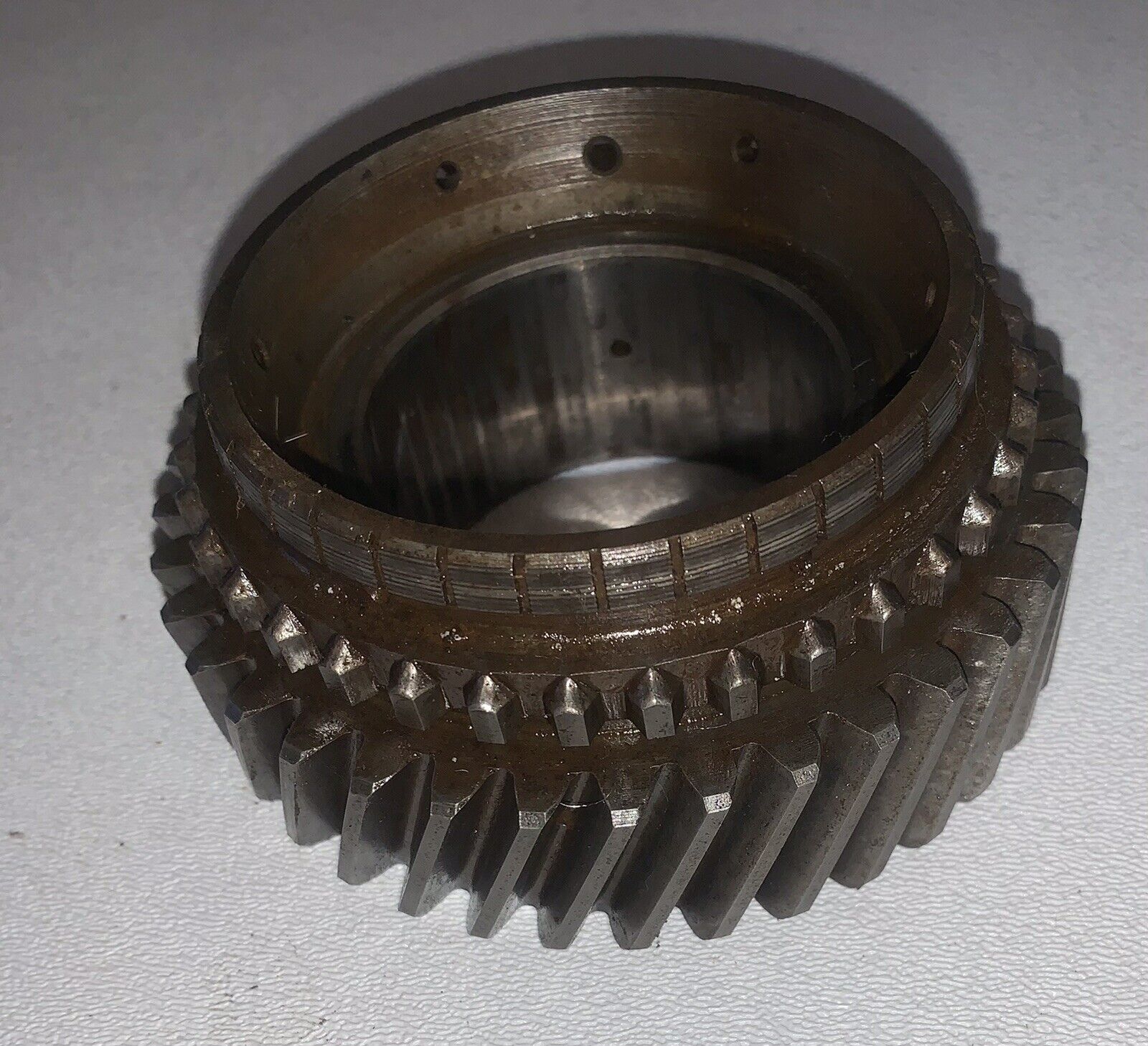

There is no assembly really. There is a synchro cone machined right onto second gear itself, and there is a synchro sleeve with an inverted cone cut into it. The two meet and synchronize the relative rotation. Moved farther, the operating gears meet and mesh.
Sleeve
Gear

Nah it would wear off in a jiff. the only way to make a used, worn one work better is to machine new synchro grooves into it. It isn’t really worth it though. The fellow from Morse found me a low mileage one for like 150 bucks or something. It just might require a new locking washer of the correct size to result in 2-4 thousandths float.
In theory… Lapping the parts will also improve performance. It is important to keep in mind that the Moss box was NEVER a slick-shifter, even when brand new. This was probably the most common complaint with the E-Type when it first came out. The Moss gearbox was designed in the '30s for one-ton trucks, not cars. It’s primary claim to fame is its virtual indestructibilty. The gears are made out of some kind of unobtanium that can withstand an incredible amount of abuse, but the synchros are poor on their best day. It does not work well, even compared to its contemporaries, but it is virtually un-killable. The trick to driving with a Moss is to not be in a hurry when you shift. Rathing than shifting from one gear to the next in a single motion, you pop it into neutral, wait a good half-second, or more, then push it gently into the next gear. When down-shifting, you pretty much MUST rev-match to make it go in quietly.
