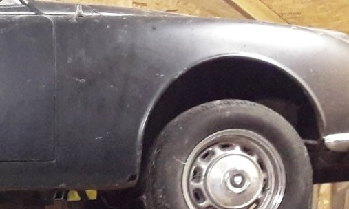

I have a thread running on another forum, the mig welding forum, but I had better post some pictures on here. I am in the UK, Essex, When I was 19 I bought a Mk2 3.8 MOD that I fitted a Mk10 manifold and triple carbs to, it was I think my third car, first (road) car was a 1960 MGA 1600 soft top, bought for £100.00 in 1973, while I was doing that up I bought a Hillman minx 1500cc for £25.00 with a new MOT, the minx was sold to buy the Jag, then when the MGA was finished (1975) I sold the Jag. Around eight years ago I saw this MOD 240 on Ebay and put a cheeky bid in for £1602.00 and won it for that price, it had been parked in a garage in 1979 and was seized up but looked very solid for a UK car, I removed the engine at work and steam cleaned it but did nothing more except look for parts, again mainly Ebay or the Beulieu jumble, when I retired I brought it home and put it up on stands in my garden shed! I am fiting the proper Mk2 bumpers and leather seats, plus a 3.4 engine from a 1985 XJ6 series3, up in the air|690x424
Don’t mention cost, my wife may read this! I was trying to be in for £10,000 (UK) but suspect it will be nearer £15,000 including the original purchase price, it is a budget restoration but to a good standard. I paid £16,000 for the car six or seven years ago, it then sat waiting for me to retire, the only job I did at work was to remove the seized 2.4 engine as I did not know exactly how my home workshop would pan out!!
The front is in high build primer, needed a clutch alignment tool, my workshop broom is 5" shorter now! IMG_20210301_173439480|666x500
