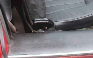

I am pretty sure the S2 seats have the flat bar and not those nice polished chrome units that were on earlier seats. I could be wrong as my car is an OTS and not a 2+2.

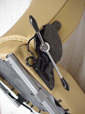

here is a pic of my seat bottom and you can see the adjusting bar on the left. sorry it wasnt the focus of this shot so it just gives you an overall look from an Aug 69 seat from an OTS

The S2 cars originally came with the flat lever as shown above. The same lever was used for both the right and left seats. They were secured with a pan-head screw with washer. The pivot covers were metal and did not have a tab that extends and screws to the seat back.
Beginning around 1970 model the flat lever was changed to the chrome, round ones as seen in Joel’s photos. They were RH and LH parts and were secured with a special chrome slotted screw and 3/16 flat washer.

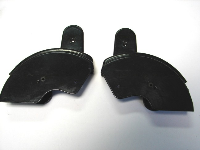

The pivot covers, still metal, added a ‘tab’ that extended to attach to the seat back. Note that the plastic covers are strictly aftermarket.
