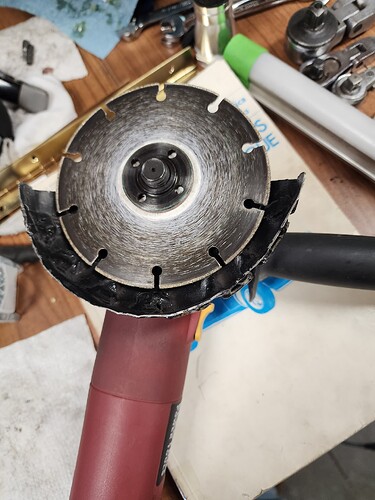

I put a 5" steel cutting blade on a 4-1/2" angle grinder (had to modify the guard for the larger blade), and now I just cut steel off instead of having to grind through it.
