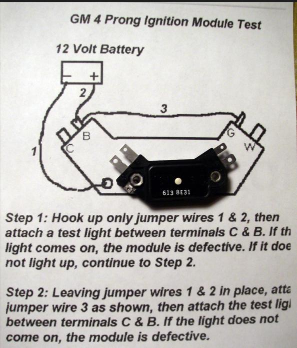

If you have a Marelli ignition system, this suggestion is likely not of any value to you… If you don’t have a Marelli ignition, then:
I’d check the ignition amplifier, a small box atop the engine on the left side, easily accessible.
It contains a GM ignition amplifier normally found in GM HEI distributors:
ignition amplifier innards
Here are instructions on how to test the GM amplifier after opening that box and removing the amplifier:
If it’s defective, fix it by replacing the GM ignition amplifier (I’d strongly suggest you buy a GM ampifier, not an aftermarket amplifier)
