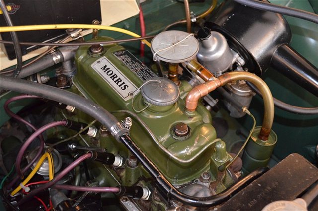

Keep in mind that, going by my 1965 3.8S, Jaguars post about 1964 did not have an open draft tube . Instead there was a different top timing chain adjustment cover which was marked as in compliance with California emissions requirements and this cover had a vertical cylindrical piece and a tube that lead to the intake plenum between the air filter assembly and the carbs. Don’t believe this was a typical PCV set up but it probably did create some vacuum in the crankcase. Other BMC cars of this vintage did have a PCV which was made by Smiths. This system fed the crankcase fumes into the intake manifold between the carb (s) and engine where there was more substantial vacuum. I have successfully retrofitted this system to older British cars like an MGTD and it does seem to reduce rear scroll (seal) leakage. Photo shows one on a Morris Minor with 1098cc engine circa 1967. They were common on Triumphs MGs and some Land Rovers. Many posters do not indicate their location so I am unsure if any have seen the Jaguar system used on US spec cars post 1964 IIRC. One photo shows this California system just behind the ceramic section of the ignition coil. The other photo shows the Smiths system as fitted to a Morris Minor.
