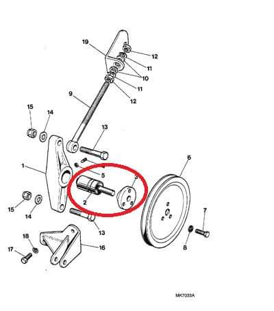

Original bearing for AC idler pulley EAC3042 is ridiculously expensive ~140eur so decided to develop an alternative option. Bearing will come with preinstalled pulley carrier so it it will be much easier to install and yes it will still be cheaper then original By the way pulley carrier is also still available new from Jaguar for another 160eur
Is this the assembly that replaces the air pump? How is your design different than the original, other than cheaper? It looks the same as the item in the diagram. Are you going to end up offering the lever too? That can just be cut out of a solid block of aluminum, can it not? Probably cheaper?

Nice! Did you make sure that the bearing is the same type as original. I cut the original open when I replaced mine âŚit is quite a ânuggetyâ roller bearing at the front with a ball race at the rearâŚespecially designed for moderate overhanging loadsâŚ

75eur including shipping, but sold out at the moment. I can make another batch if there is a demand for them

Are you painting the flanges after pressing them onto the bearings? Why?

Is the pulley on the air pump the same as the pulley on the idler? So you can just reuse your original pulley? Or do you have to buy a pulley to replace your air pump with this idler arrangement?
I have one of these. Excellent quality. Uses the airpump pulley. Fits the original bearing holder great.
I can use everything original apart from the bearing which is obviously on its way out and has quite a bit of back lash and is noisyâŚ

Yes you can use the pulley from the smog pump. Thatâs what I did on my car.
