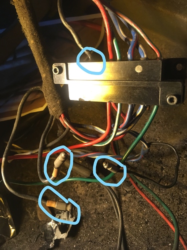

I ran into another problem as I was assembling the diaphragm parts. The connector block disintegrated an I bought a new one BUT I realized that a number of black wires (ground ?) were not connected to the block although one was. In the attached photo, you can see three black wires that are not connected and one (with grey paint on it) that is. It seems to me that I should just connect all of them together but I thought I would ask for advice.

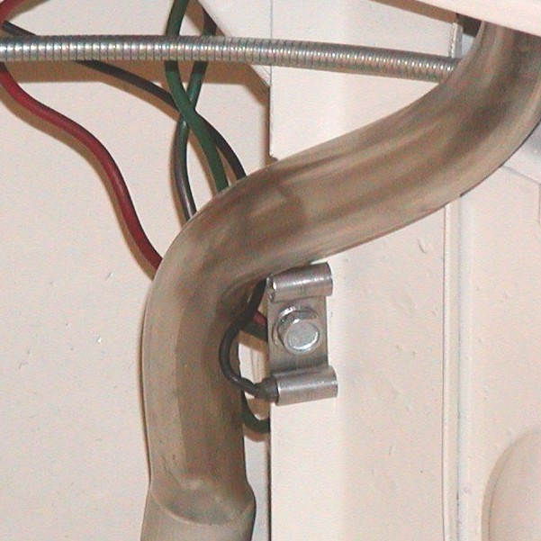

It looks like the black wires that are not connected are all ground wires from lamps. All lamps had a direct ground connection. Generally lamps had a ground connection like:
which will be somewhere in the area. Looking at your picture there should be a black wire going from the opposite side of the black wire in the connector to a ground connection. This is the wire that grounds the bonnet to the frame.
