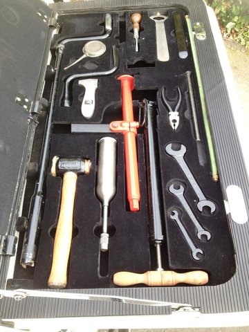

Yet another version of the tool kit tray. Sigh. Luggage strap loop and lid closer are different from mine. Is there a slot for the tyre pump and jack, and if so, what jack?

Handbrake is one of the correct things. The tool tray is probably good too.

The Tool Tray is exactly as expected for what I call a TYPE D Tool Tray, so unique to 1937MY 2-1/2-litre Saloons, and is different in several areas from the 1936MY 2-1/2-litre tool tray (my Type C), and both 1936MY and 1937MY 1-1/2 litre Tool Trays. And totally different to the significantly revised 1938MY tool tray that was common to 2-1/2 litre and 1-1/2 litre cars.
Rob - look carefully - The tyre pump recess and the Jack recess are co-joined. Look in centre of tool tray, note the slot for the STEVENSON Jack foot and the Arm heading under end of adjustable, and the tyre pump handle on the right-side edge with one of the fold up feet under the pliers. The big gap in the middle is a recess for the tool-tray lid lamp, something added for 1937MY tool trays, and not yet included in 1936MY.
I don’t have exact chassis number demarcations yet between 1936 and 1937MY tool trays, so may not be exact, but am working on improving my current demarcation with more and more sightings. Haven’t yet worked out this cars Chassis Number, but I have a few options, but maybe if Shannon’s reveals number that will be a more positive ID.
The two tools included - the Pliers are clearly wrong, being the style introduced in about 1951/2, albeit close enough in key dimensions to still look OK in recess. The Adjustable Spanner COULD actually be its original, there is many many brands of these ‘Girder’ Adjustable Spanners and a lot of detail changes in shape/dimensions and adjusting wheel over their 1936 to 1954 period of SS/Jaguar use (and into the 1980s), and this one so far ticks all the boxes for 1937MY. Be a fluke if it was original, so maybe just a lucky swap meet pick-up?
And yes Rob, it is familiar STEVENSON Jack with clamped in position ‘H’ beam forged arm, as introduced with the first SS-Jaguars………
Very good, so the tyre pump fold-up feet are alongside the pliers, and the jack foot is by the adjustable spanner, and there appears to be a piece of wood broken away between the tyre pump and jack.

Tool Tray is interesting - close, but not quite right, albeit a pretty reasonable effort at something approaching authentic. My guess is this cars original tool tray was either damaged and major repairs, or a reasonable effort at copying an original or partial original more likely, with a few mods/tweaks to better accommodate some wrong tools to be included. The Tyre Pump is glaringly wrong, and the recess for it clearly modified extensively in length and shape to accommodate. Always hard to find a good original as a definitive reference, but I now have a good few. The Shannon’s 1937MY cars tool tray is a much better example, a few minor repairs needed, but otherwise original, but a good clue to cars identity rather than their advertised 1936 claim, although it could be late 1936 built after intro of 1937MY cars.

Curiosity snuck up and trounced me as usual, so I did a bit of digging in books and on ssjaguardata, and found several with that handbrake, but here is another type in car 11230.
And couple more with that tool tray. Here is 10520.
Here is 11963.

10520 has what I call a Type C tool tray, and is unique to 1936MY 2-1/2 litre Saloons, given I am not 100% (yet) on exact demarcation, but Alan Crouch quotes 1936MY to be from 10001 (Oct 1935) to 11449 (July 1936 dom). This is one of the better examples of my Type C, being original/unrestored and in this photo clearly shows as not having any tool-tray lid Lamp, thus no provision in tool tray plywood to accommodate. Indeed it even has what looks like a few original tools, including the side mounted spare-wheel nut spanner.
11963 however is not such a good example, having been extensively restored (in Australia), and not at all original, although in the scheme of survivors probably one of the now better examples of my Type D Tool Tray as used exclusively in 1937MY 2-1/2 litre Saloons, again according to Alan Crouch from 11450 (Aug 1936) to 13445 (July 1937). These now introduce the Lamp mounted under the tool tray lid, and thus a need to rework the ply-wood to accommodate the protruding lamp.
Note the positions of tools in the front-right corner in particular - the Adjustable Spanner, Oil Can and Jack Handle, and also the curved corner to the Jack recess to accommodate the lid-lamp.
1936MY and 1937MY 1-1/2 litre cars had a quite different tool tray - my Type A and Type B, as did 1936/7 TOURERS. For 1938MY (Nov 1937 on) cars such as yours, a totally different tool tray with a major change/revision in the actual included tools was introduced, but was now common to both 1-1/2 and 2-1/2 litre saloons.
I am always on the look out for more examples of surviving 1936MY, 1937MY and 1938MY tool trays and tool kits - its one huge jigsaw puzzle to sort out in detail, and I am still missing many pieces to positively identify in detail all the included tools, but am at least advanced enough that I can identify modified tool trays, and wrong tools.

However, there is clear evidence from factory sources, as well as multiple surviving examples, that regardless of 10467 being a 1936MY Saloon, for reasons yet unknown its current pictured tool tray is the revised design introduced for 1937MY 2-1/2 litre Saloons. Judging by all your other comments, seems like you agree that there may well be many aspects of this car that may not be original, which is not all that unusual for an older restoration of an SS Jaguar with many gaps in its long history. It was not hard to find beyond restoration/interest donor cars (if you were looking for one) in Australia back in 1960s/1970s/80s with about 50 of these 1936/7 2-1/2-litre Saloons being sold new in Australia, with now only a handful surviving. But for my purposes, still a nice photo of what looks to be a reasonably good/original 1937MY tool-tray, but sadly no tools seem to have survived - although surely a few must have been found from back then. Maybe got lost in the later ownership, the earlier long term owner/restorer was a well known hoarder.

My comments were 100% about Tool Kits/ Tool Trays - I don’t pretend to have any expertise nor indeed any great knowledge about any other aspect of 1936/40 SS Jaguars, as others certainly do, and as others may claim.
So I still say its a 1937MY 2-1/2-litre Saloon (only) Tool Tray, but of course if you have any comment or rebuttal, I would love to hear it and see your evidence. I am always on the look out for constructive comment. If you want more detail about my SS Jaguar Tool Kits research, apart from what I sometimes offer on this forum when topical, you will have to await my ‘book in progress’
