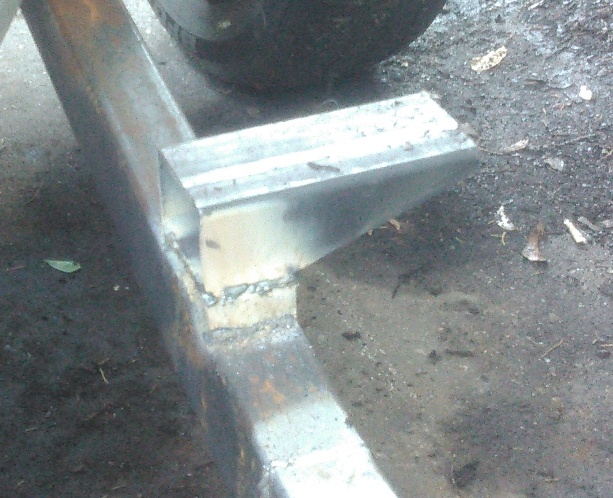

Small progress last night, added uprights to the rear of the chassis. Good thing I have plenty of rock wheels to smooth those welds…
Thanks to the Friday flooding, the weekend was nearly a bust due to the slop and slime but I did manage to build and booger weld on my cowl mounts. They may seem high and wide but I have practical reasons for that. The Cowl is going to be heavy and have the steering column, brake master and pedal, and sundry other systems mounted on it, so it’s gonna have more mounting area.
That chassis and cowl has been dismantled and I’m going along a different route now. Several serious mistakes were made during the build and they added up to sub-standard safety situations and an overall fit of frustration with my lack of skills. That said; there is life in this project and I intend to follow it through to a more harmonious outcome. No more using just any old scrap steel that falls to hand!
