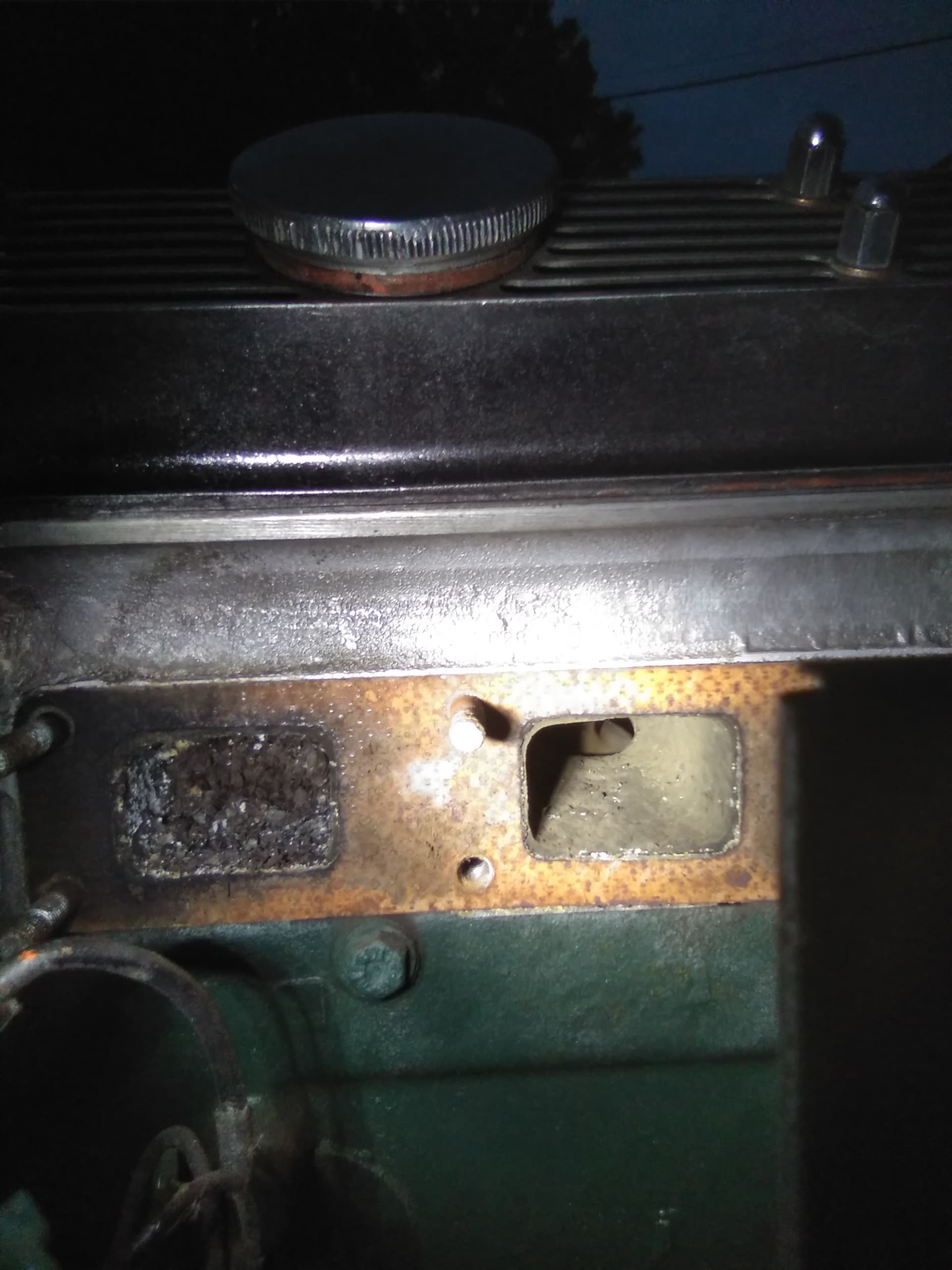

Unfortunately once I got the exhaust manifolds off the engine I discovered a very weird surprise with this engine. See the photos below (these photos were taken after dark so please forgive the quality of the lighting):
Exhaust port on cylinder 6 (front cylinder closest to timing chains)

So the whole exhaust port for cylinder 6 is completely blocked up with crap. I have no idea what would cause this. Anyone have any ideas?
looks like little critters have been living there
mouse poopies. I hate those ******* little things

I agree with the others that it looks like critters(mice?) have been living in there. How many years did this car sit before you removed the exhaust manifolds?

It sounds like the mouse droppings are a minor issue compared to your other challenges. I suspect that the mice made their way up the tail pipes to get to the exhaust ports, so don’t be surprised if you find more mouse dropping inside the tail pipes, mufflers, and other parts of the exhaust system.

It looks like aluminum globules mixed in. Not great of course, but the horrific piston photos will keep us on the edge of our seats. :laughing:
I do have one of those USB bore scopes. Might be interesting to take a look down in each cylinder.
critter crap in the port, might find dead hamsters on the crank shaft
