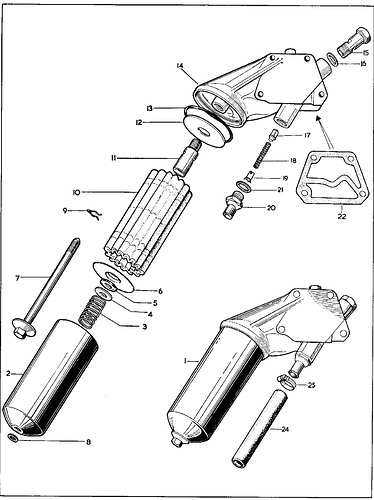

That’s a trick question. That is not the correct oil filter housing for a 1962 MK2. It is, however, the correct filter housing for your LA1118 engine, which came from a 1960 MK2. You can compare your engine number to others and get a reasonable approximation of when it was made. For example, this engine number is close to yours:
By 1961 they were using the down-at-the-back filter which would probably fit better in your car.

It appears you have this one for early Mark II.
Mike Eck is suggesting one of these for later Mark II.
Mike Spoelker is suggesting this one for 3.8 E-Type.
Another possibility is this one for 3.8 Mark X.
And this one for 4.2 XJ6.
And this one for Mark IX.
With any change you must be sure the oil circulation is happening correctly, as there were modifications made to the oil passages to mate with each of these filter heads.

I agree with this in general, but about the only major change over the years was the elimination of the internal bypass port in favor of an external hose that ran back to the sump. You do need the correct gasket for the base. The oil filter feed is from the bottom left port and the filtered return is through the center top port. There will be a smaller 1/2" port just above the supply port that may or may not be threaded. If it is threaded (1/2"-20 UNF) it is plugged, as is shown in the attached photo. The hole is left over from when the oil supply hole to the center main bearing was drilled. It passes directly through the main oil galley, so whether it needs a plug or not depends on the filter head gasket pattern. There is no risk in plugging it. Once plugged virtually any filter head can by used without concern for compatibility. Early blocks have a third large hole on the bottom right of the mounting pad that goes directly into the crankcase. Those filter heads have no external bypass hose and the sumps have no fitting for that hose. You can use later external bypass filter moubts on early blocks, but you will need to plumb a port to the drain.
