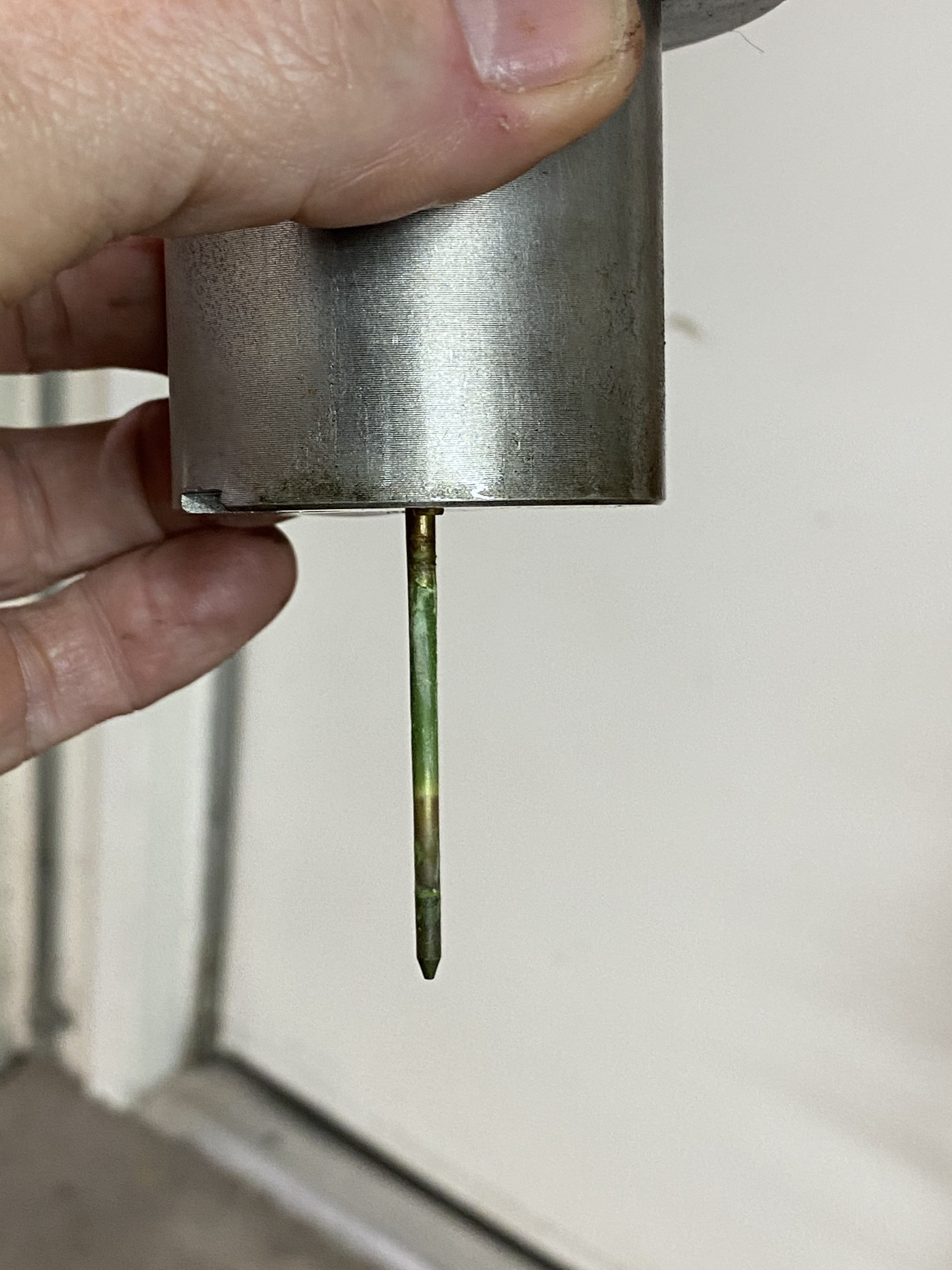

Spraying starter fluid in the front carb revs the engine and raises the temp of the front two header tubes. Raising the piston on front carb by hand seems to have no effect but raising the piston on the others bogs the engine. So, it looks like fuel is not getting to those front cylinders. These carbs are rebuilt but I noticed what looks like a “green film” on the jet needle, almost like how brass can go green. I could wipe off a spot with my finger. Maybe the jet is clogged?

Removed the fuel, removed the dome and jet needle, the needle had some kind of green build-up on it. (pic)
I used a can of carb cleaner and its straw to blow out the passage from jet to bowl, and wiped it out thoroughly. Also ran a cleaner soaked pipe cleaner down the jet got the same green stuff on the pipe cleaner.
Put the float back in checked the valve (ball valve) still works, reattached the fuel supply and ran the pump. I saw the fuel come up just to the top of the jet. It was pretty dry when I opened it.
Cleaned the green stuff off of the jet needle wit a scotch pad and reassembled.

Also note that you’re showing an open float bowl and, separately, the needle of the piston of the carburetor. This is not to be confused with the float needle, which will be either a little rubber pointy thing or a ball bearing Gros Jet that works within the forks of the float, also not shown. The failure of that needle can starve the carburetors of fuel.
That said, cleaning everything will fix your problems. Also note that changing the carburetor piston needle seat (rubber contraption surrounding the little brass hole the piston needle goes through) but keeping your original piston needle cleaned and intact will not affect the tuning of the carburetor. Just be sure to keep each carburetor and its parts as a matched set.

This was some type of “stuff” preventing the fuel from getting out of the jet.
