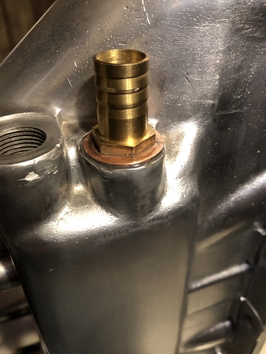

So, it’s done. I installed the brass fitting, using JB Weld. I applied the JB like it was a thread sealant, coating the full depth of the threads on the brass fitting, and then “screwed” it in. In quotes because the thread engagement was limited. I opted to include the copper washer for two reasons, first is the esthetic of it being expected. Second is that it offered an additional sealing surface, as it does in its normal function. This was a bit different as the backside of the washer also has a a bit of JB on it.
So now there’s not much to do but wait for it to set up, and then assemble and pressurize the system and see what happens…
